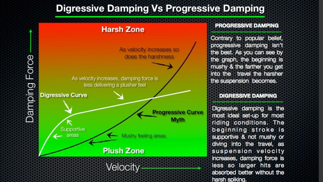

So you're going to get a bunch of opinion. After a long talk with [MENTION=63487]A.Wilson013[/MENTION] I decided to buy the icons. He rode in a truck with the equivalent king version of what he had and couldn't tell a difference. That being said...icon is digressice, king is progressive. Before you get 1000 opinions, here is a graph that should tell you all you need to know about what you want. Outside of the spring rate on the coil lol.

[MENTION=110387]jstim[/MENTION] that is an great graph to show the differences between the two. Is that graph for offroad or on road conditions? On a street car I can see the benefits of digressive but for offroad conditions, it seems like progressive would be better since you would have softer dampening for the little bumps and stiffer dampening for the big hits like whoops, dropoffs, ruts, etc to keep you from bottoming out harsh.
I'm sure either one will be fine, especially if tuned properly but overall I think there is a general consensus that progressive is superior for offroad conditions.
On road or off would be the same. I mean, that graph is a general explanation of the difference. If you were going to compare King to Icon, you would have to pull their data to compare curves. This is one of the best explanations I have seen, and gives you the best idea of what your shock or coils are going to do. I'm with you, fast through the desert, King is the way to go, again according to how progressive vs digressive works. My rig is made for slower, overland type excursions, and I drive it a lot on the street. So I am running Icon.
What I mean was the differences of progressive vs digressive based on the notes it's not talking about offroad suspension. Probably road cars or motorcycles. The notes are biased. But yes I think we both agree on the application plays a big role in what type of shock you should go with.

By the way, that webpage you posted above is from a website all about upgrading Honda Elements. And the graph that was posted above that was in regards to Mountain Bike shocks. Either way they still describe how digressive and progressive works but they are referenced to different applications.
