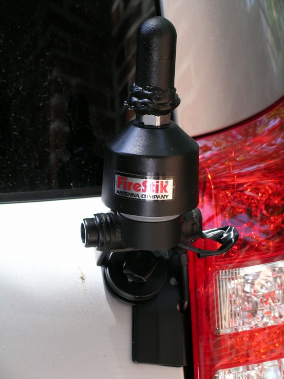

There is a 90degree piece that you can buy to rotate the antenna and it also locks it into the desired position 0 or 90. Only thing that I would warn is that the antenna will get tossed around pretty good up on top since it is now a couple feet higher than the car.
Honestly, if you do not use the antenna all the time, why not just use a mag mount that you can easily detach and bring inside the vehicle when you are not using it. Mine resides in one of the rear cupholders with the antenna screwed in.

Mike, I checked out Diamond Antenna, their cheapest mount is $75 directly from them. Which mount do you have and how much was it? Thanks, Nathan
My antenna (Firestik3) doesn't move at all, even on the highway. I don't know what antenna you had that "whips around".
I also have a quick disconnect so you just push down and twist and the antenna comes right off, I usually just throw it in the back seat.
As for grounding, i had my doubts too. But I checked it and its good back to the battery. You can see the little wire jumper I made in one of the pictures. The top bolts of the rack were connected to the bottom, which go right into the roof/body.

I am sorry I was not clear. When you go off road you will sometimes find yourself around trees with branches that hang over the trail. When you drive, and in your case, have an extra 3ft sticking up, your antenna will continue to hit tree branches. I have seen this with magmounts as well with long/thick antennas and sometimes the force of the bend causes the mag mount to come loose.
Now you have a disconnect and not the 90 degree piece he mentioned, so that is another option as well for when you are not using it.
Thanks for the pic Mike.
