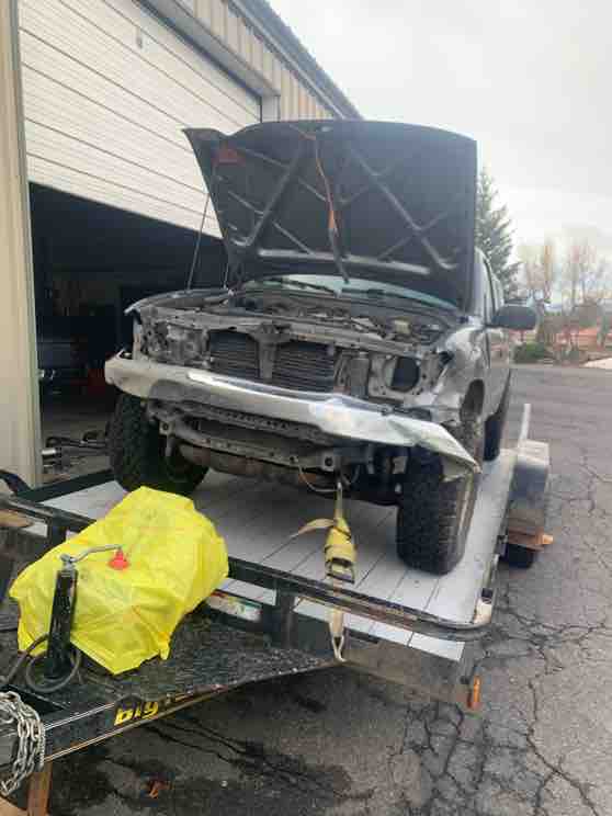

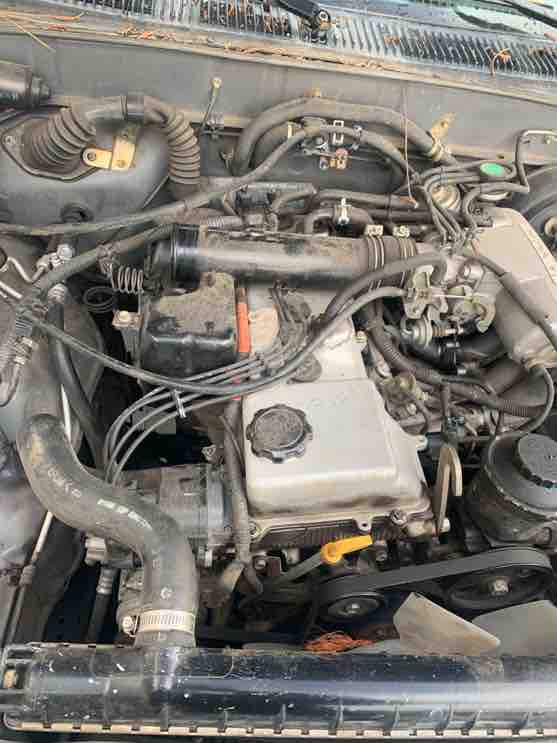

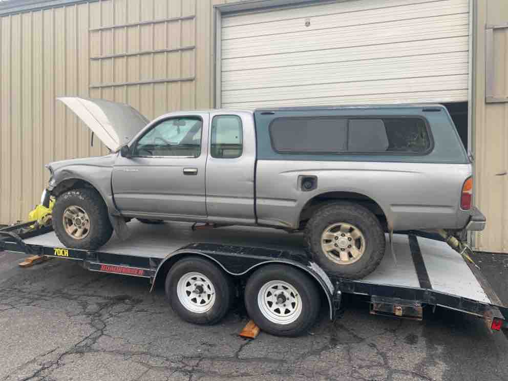

Hey I’m in the PNW bend Oregon in fact, and I bought the truck and paid only 1200. Gonna have it home on monday IMG_0021.jpgIMG_0020.jpgIMG_0019.jpg

Good deal. I just bought an 02 5 lug auto for the same price with 90k mainly for the motor, mine was smashed a lot worse though. You've got a ton of good parts there for sure.
