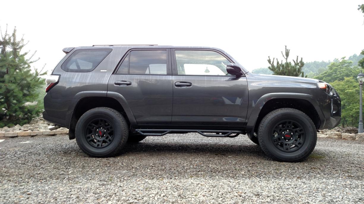

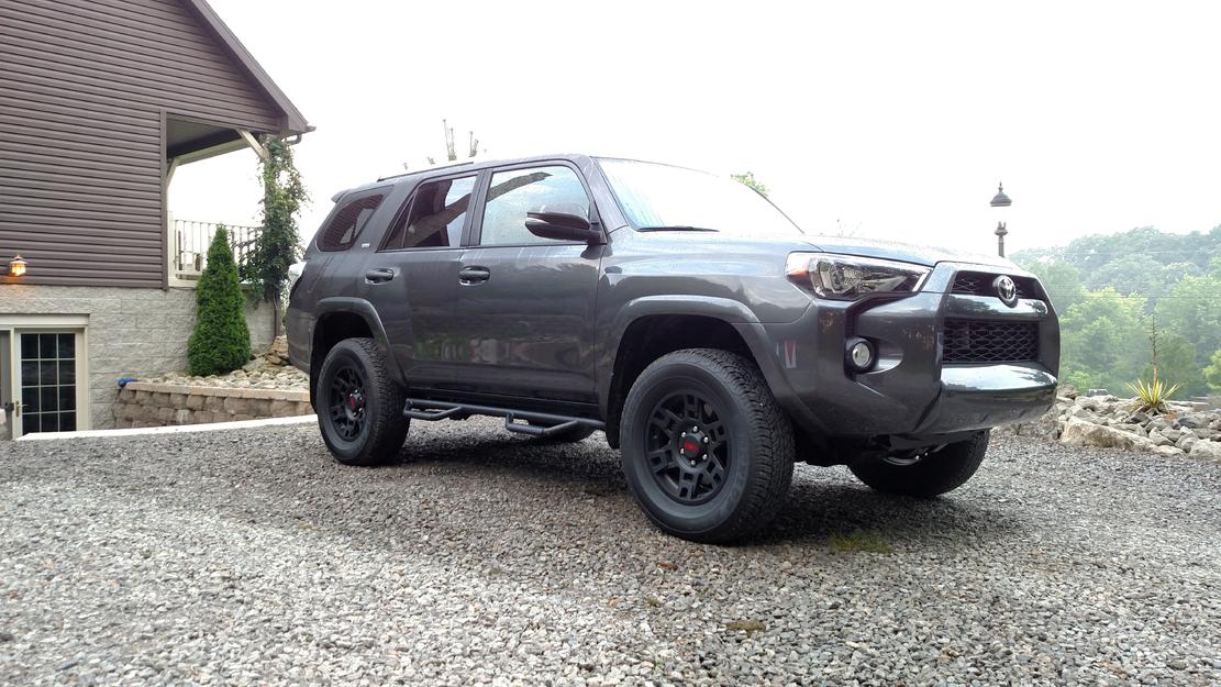

Here's what I'm starting with.

My trim packers and front top hat spacers arrived ahead of schedule on Friday. I was able to get them put on Saturday night. My 4runner sat as follows from the factory: PF 20.0" PR 22.0" DF 20.0" DR 21.75". The top mounting studs on the struts were too long, so I had to trim them so they wouldn't hit the strut tower. Other than that everything went pretty well. To remove the struts I removed the two bolts for the bottom ball joint, completely disconnected the sway bar ends and unmounted the sway bar from the frame, removed the bottom strut bolt and the three nuts on top of the strut. I was the able to lift the upper control arm while pushing down on the lower control arm. Fortunately my dad arrived just in time to help finagle the sway bar out of the way and pull the strut down and out. Unfortunately he couldn't stick around so I did the other side by myself. It was pretty tough but I was able to manage. After I got everything put back together and measured the truck it was at PF 22.0" PR 22.0" DF 22.0" DR 21.75".
I wanted .5" of rake and no drivers side lean. That's where the OME trim packers came into play. I purchased 3, 2 for the drivers side and one for the passenger side. The rears were much easier. After jacking the truck up and putting stands under the frame just in front of the wheel wells I disconnected the verticle bolt mounts for the pan hard bar. I then put a jack under the rear axle and disconnected each lower shock mount. To install the drivers side packers I slightly jacked up on the passenger side of the axle while pulling down on the driver's side of the axle. The spring pulled right out, I slapped two trim packers on it and put it back in place. I then jacked up the drivers side of the axle, pulled down on the passenger side and yanked the spring out. I put one trim packer on that spring and pushed the spring back into place. Put the shocks back on, reattached the pan hard bar and I was done. It now sits at PF 22.0" PR 22.5" DF 22.0" DR 22.5". I think it looks nice and I'm pleased with the ride. I will post some pics tomorrow if I get home from work before dark.

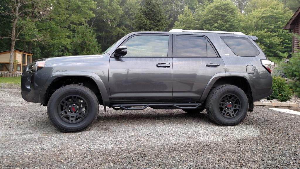

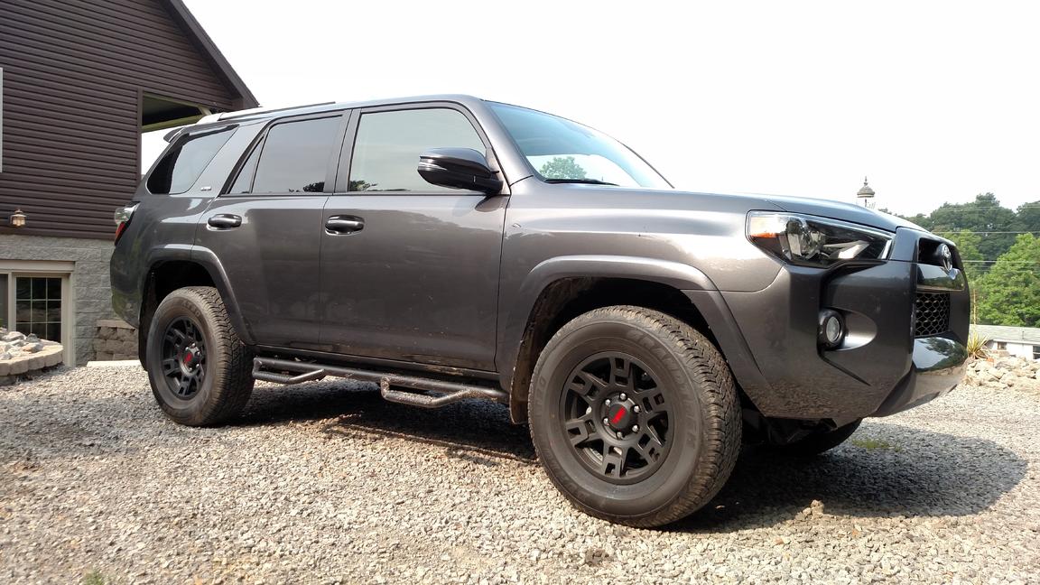

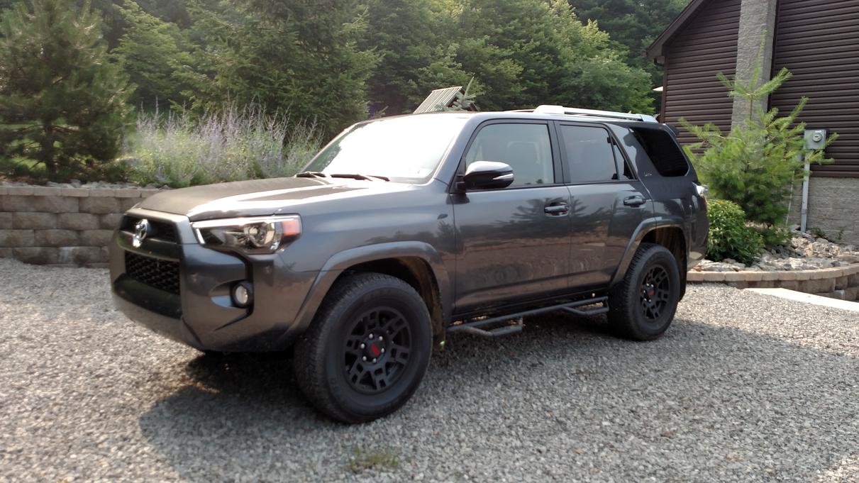

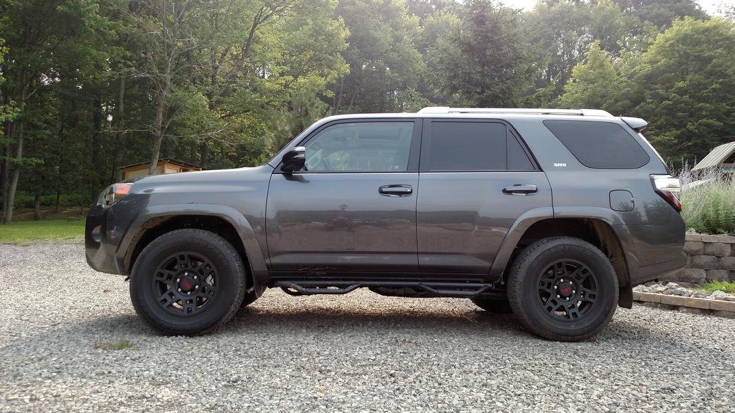

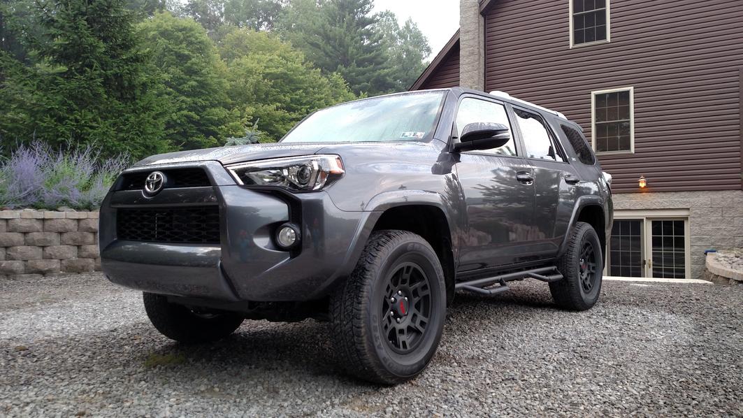

Here are some after pics. It's very subtle but it makes me happy! I am content....for now...

Great looking ride. I think it looks good before and after but the little extra height in the front afterwards helps out. Like you said subtle. Great color choice.

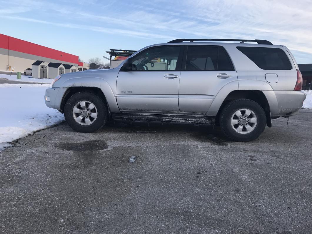

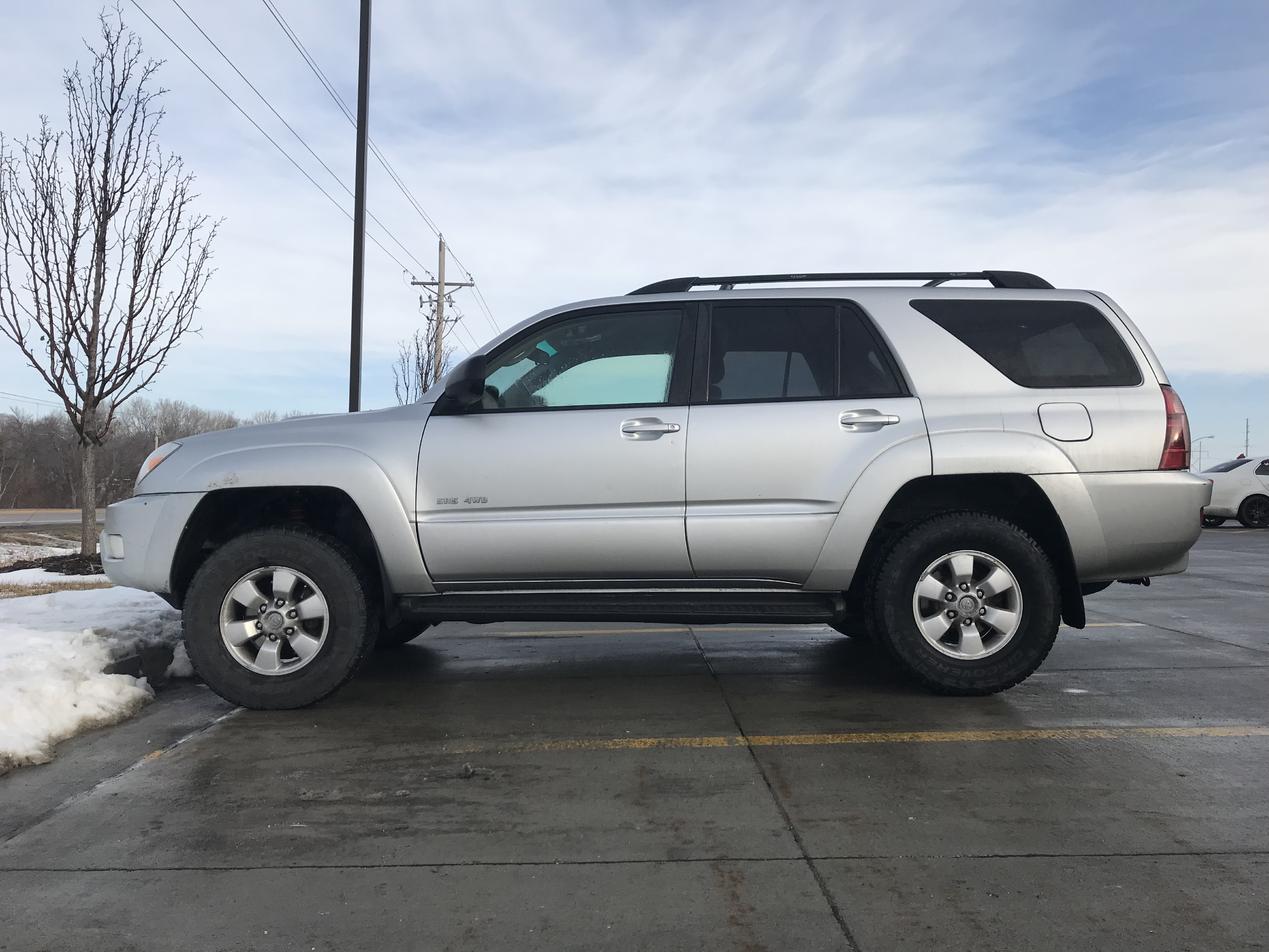

'05 SR5 4Runner before and after Rancho quicklift strut install front only
Before image with stock struts sagging a bit after 195K miles. Standard tire size in both images. Before measured 33 inches from ground to fender front and rear was 36 after lift sitting level mostly 1/4 inch lower front than back with Rancho Quicklift struts on the softest setting. Front only Rear has stock shocks.
Old struts were sagging about an inch in the before photo 1- Photo 2 has the new struts after 2 days of settling
