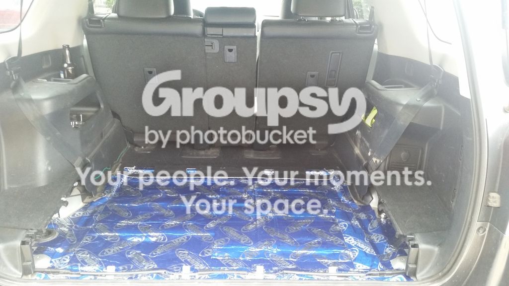

step one, remove seats/install dynamat
20150529_171834_zpsveons6zv.jpg~original

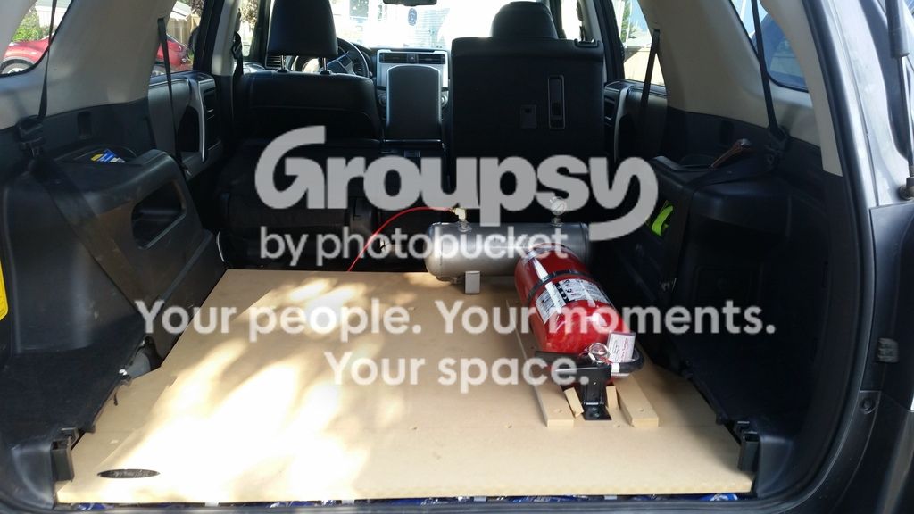

step two, install base (in my case, leave it like this for ~1 year
2015-05-31%2018.40.30_zpsb267dmdu.jpg~original

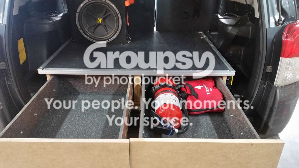

step three, build drawers
2016-03-27%2018.48.25_zpsopjfapot.jpg~original
