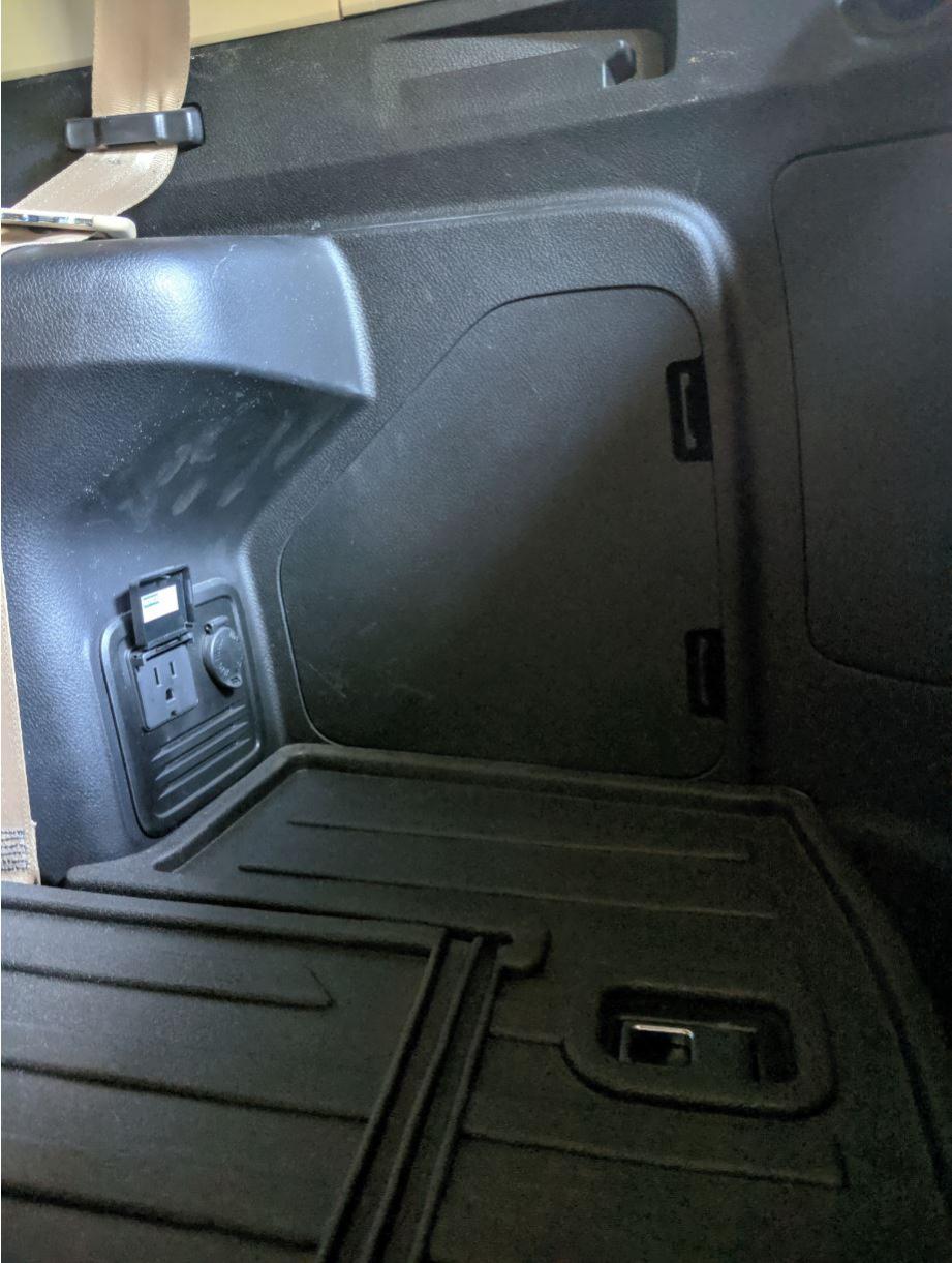

Third row seat removal to access rear panel pocket, subwoofer install

Hope this helps those who are looking to remove their third row seats or add a subwoofer. I wasn't able to find any threads detailing this info with pictures

The enclosure is the same, however if you don't have the third row then you don't have the pocket I'm showing here. I've seen one person do this with the larger side pocket trim piece but they had to hack apart that panel to make a hole for the subwoofer
