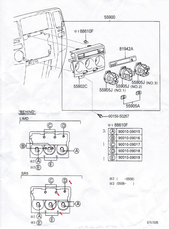

Awesome thread. I pulled the panel apart in a few seconds, and realized some of the smaller night illumination leds were burnt out. Ordered 3 x part 90010-09015 for $5 a pop. Will be nice to see the controls again at night.
If you want to save even more money you can replace the bulb in the socket yourself with bulbs from Radio Shack. Bulbs are $1.99 a pair. #7219 Micro Lamp.
Take out the old bulb, straighten the wires, cut the wires on the new bulb to match the length and you are set to reinstall. I did all the bulbs in my panel last weekend, under $10.
