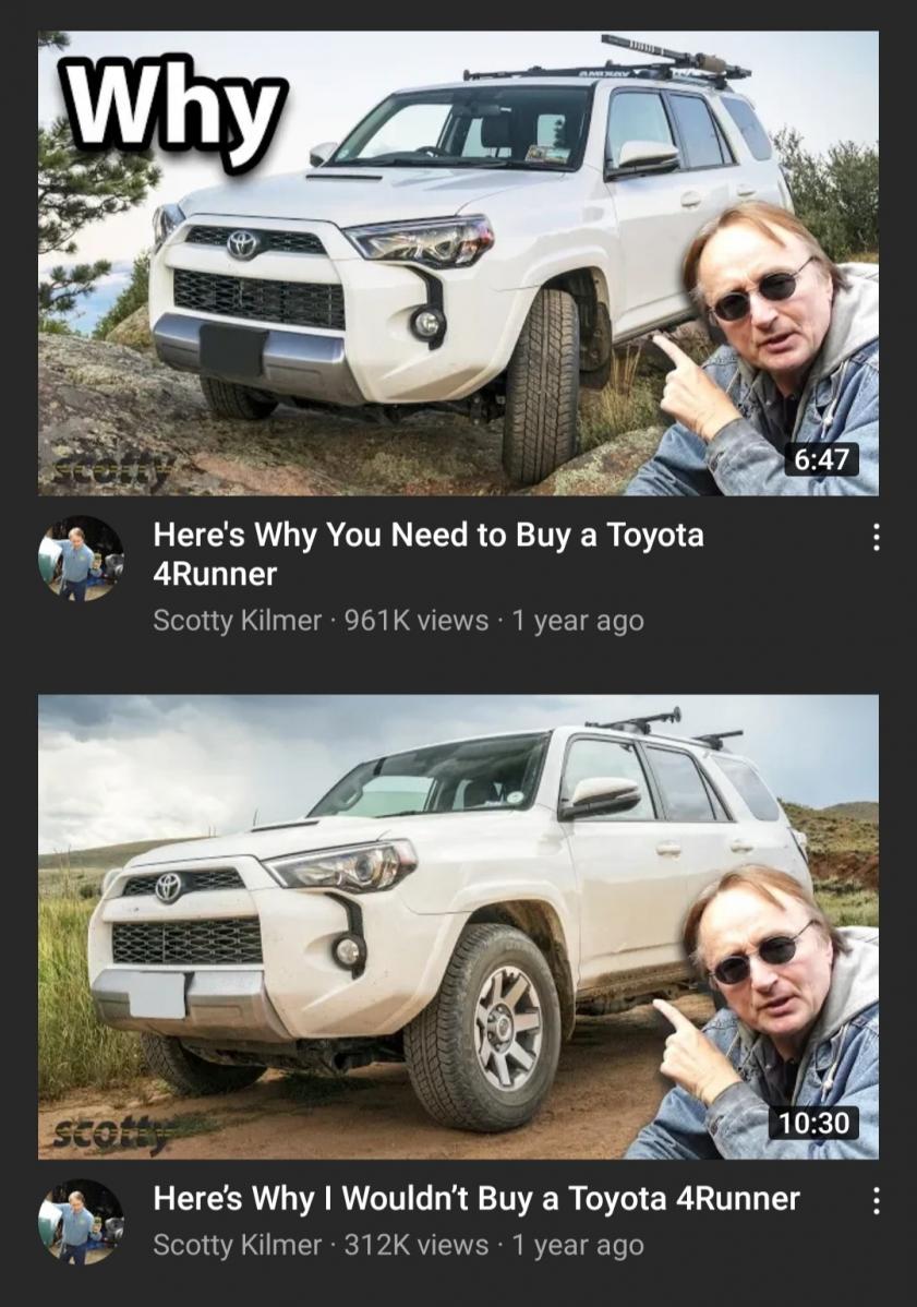

it's thanks to all the Scotty Kilmer videos i watch while on the toilet that i actually know what this thread is talking about. :dance:
Oh boy. Pic related :lol:
