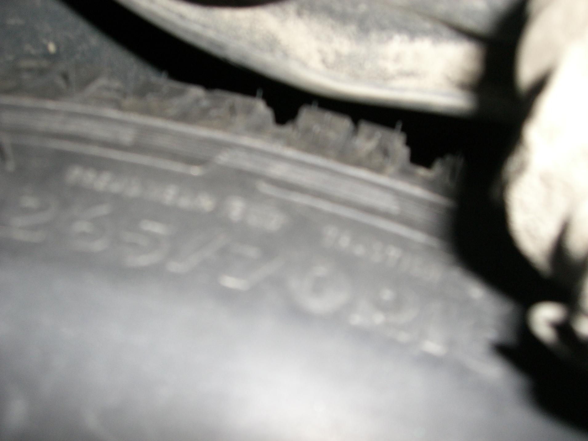

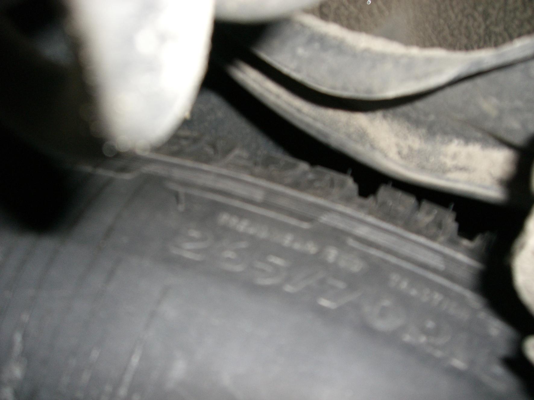

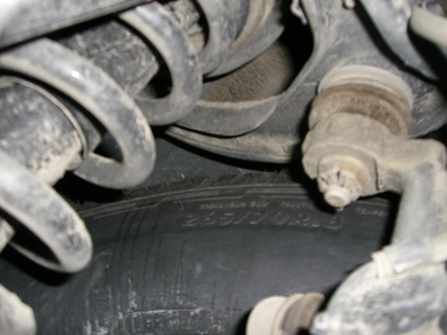

I washed my car today and very shortly after noticed a grinding or rattling while hitting the breaks . I then shortly after felt a rattling underneath my feet when hitting the breaks. This all happening at a very low speed.
I thought it may be the Emergency break sticking, but I never had it engaged to begin with, so I pushed it in and out to ensure its release.
After the breaks warmed up a bit, the problem went away.
Any ideas?
I just had the stock 17's replaced with Limited 18's yesterday and new tires.
What the hell!!
Damaged ABS Sensor maybe?
Did you get alignment when they installed the 18's? Were the 18's balanced?
Well, Im pretty sure I know what the culprit is. The tires are 265/70 R18. The edge of the tire will hit the control arm when I hit the breaks when the steering wheel is cranked: see photos

For your problem it's probably just rust on the rotors, otherwise clearer pictures would help.
