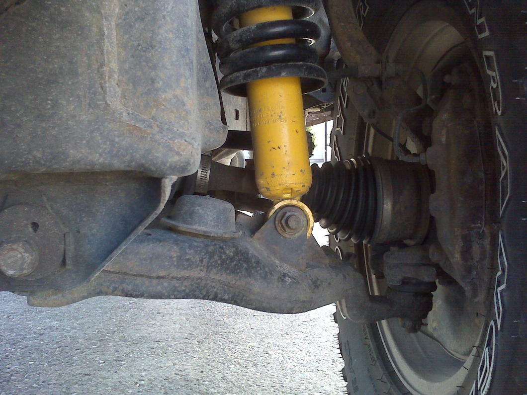

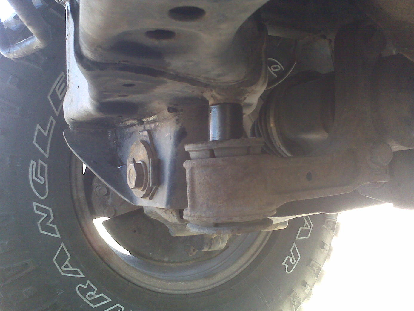

Diff drop,This look right?
Diff drop installed from Sonora steel. (curious why they have an angle where others dont)
didn't seem to level the CV angle that much, but wanted to make sure before I start driving and wheeling.
was I supposed to leave on the top rubber part?
thanks

Yep looks good. I have the SS drop too. The concept behind the angle is that it sits flush with the steel inside the rubber on the diff. It did/does look kinda weak, how thin they are, but wider doesn't mean that they are supporting any better. I've been running them for years with zero issues. And yes it drops the diff as far as it can. My ADD is a fraction off my cross brace.

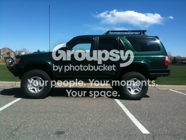

Off the subject but thanks for the LC 9.25 coils. I finally got them in and am very happy with the ride.

Looks good and great to hear they worked out for you.
