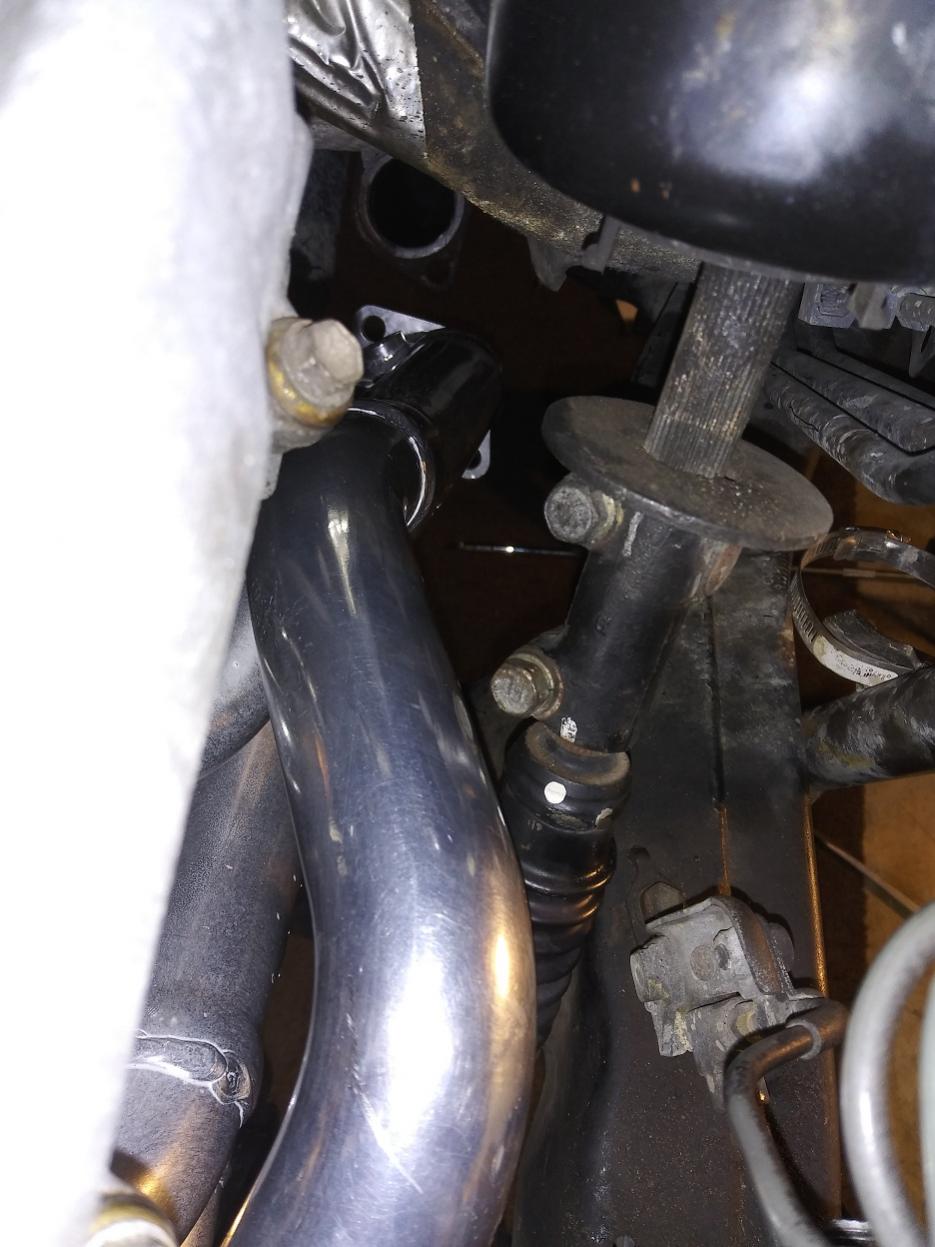

If your going with Long Tubes here is how they fit with a 1" BL. Plenty of room on mine.
