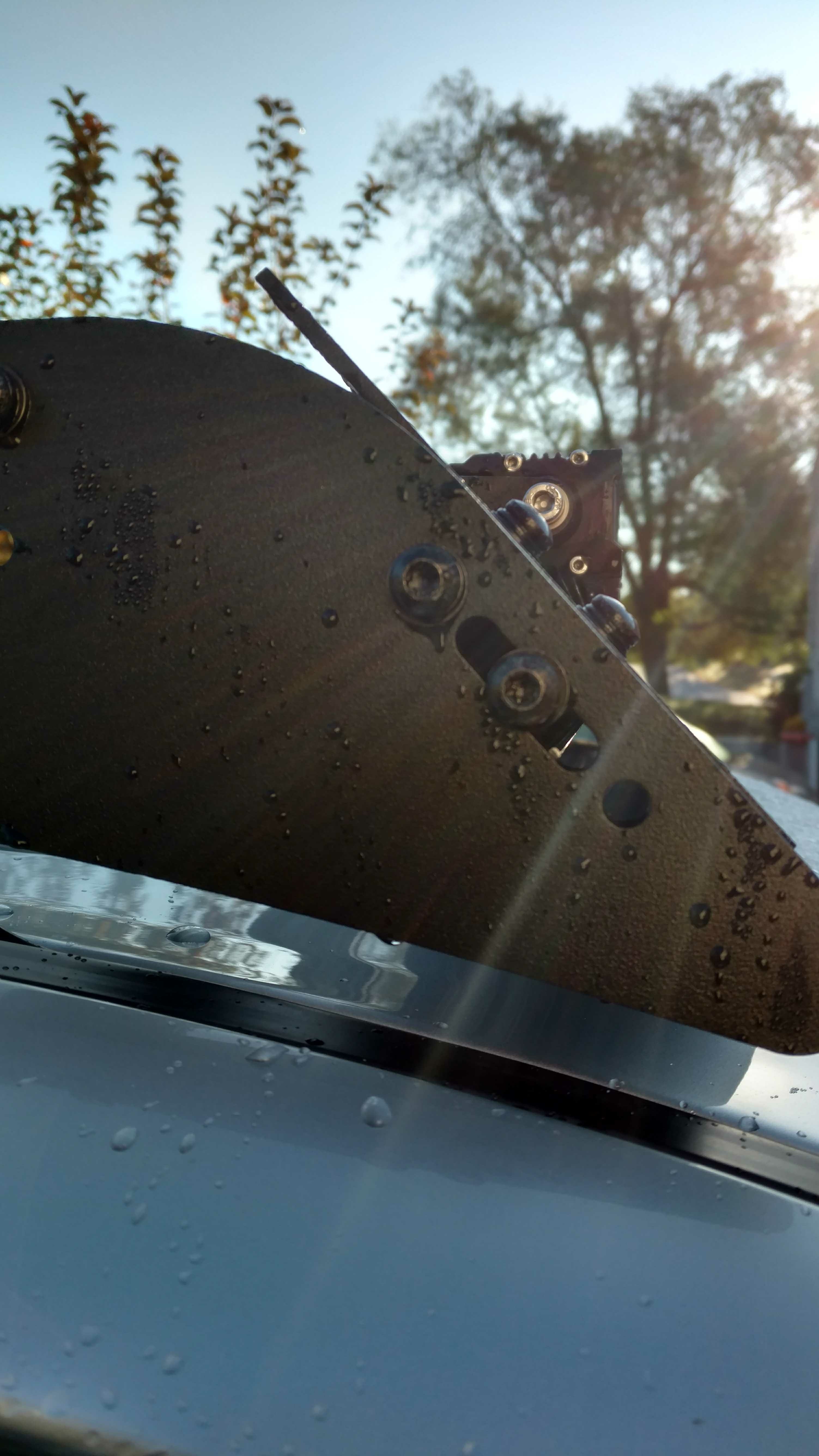

There are holes on the side for different settings. I took a picture of mine to show how I got mine set and the space I have from the roof to the rack.

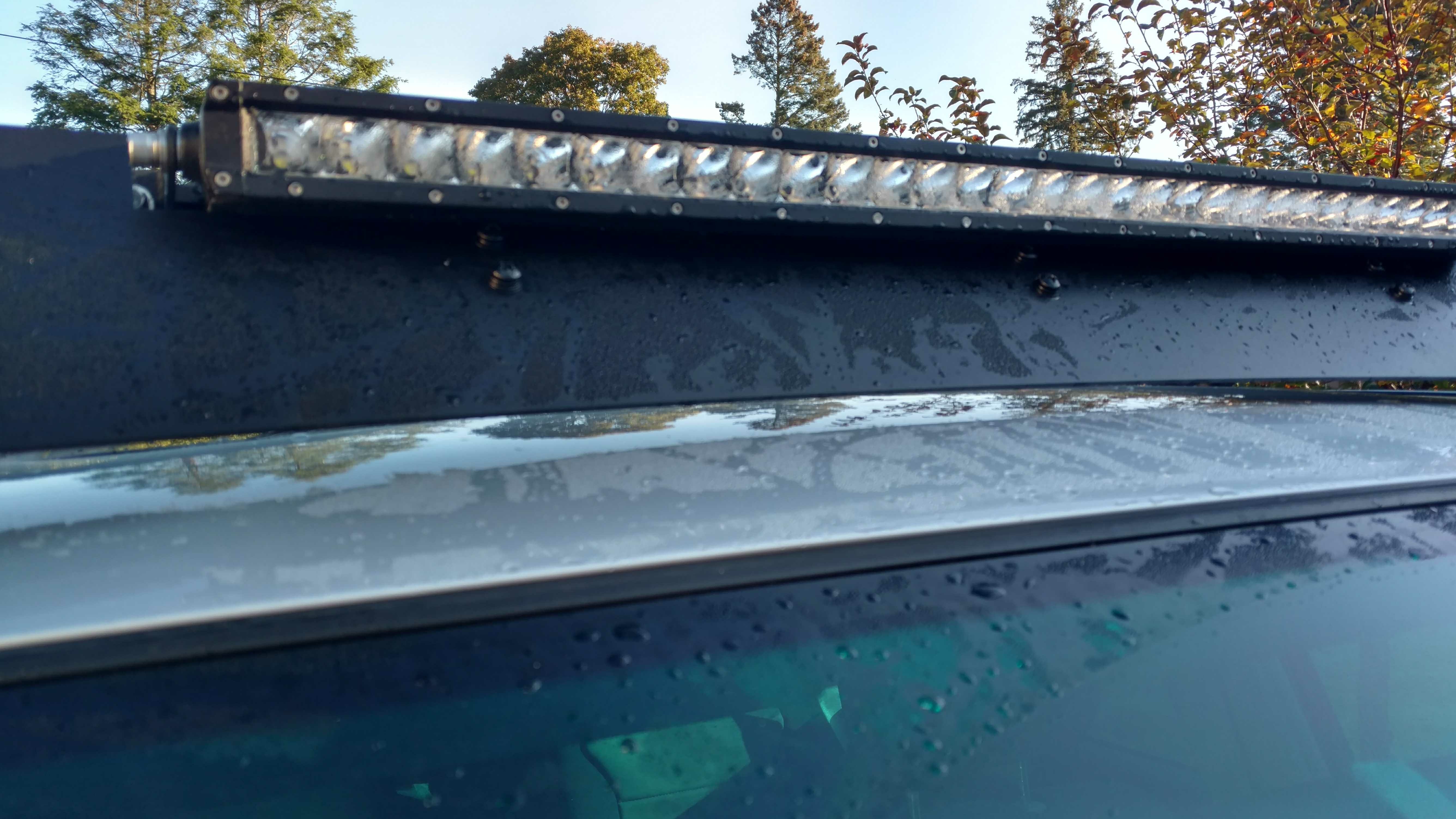

Installed Prinsu rack this weekend
Had no issues with fitment at all, was a super simple bolt up and everything went together as advertised. I had the wind deflector cut out for a 40" light bar. Hardware was all correct too.
I did have to move the rear most crossbar forward to clear enough space for a Gobi ladder.
