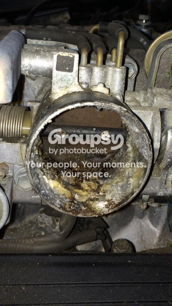

I am doing a head gasket on my 95 4Runner 3.0 and apon removing the throttle body I see this crazy gunk Iv never seen before as in the picture. If anyone has seen this crap before let me know the reason this is here.

In a generator or lawnmower, if the gas sits in the carb bowl for a long period of time. It will first turn to a neon colored gatorade and at that point it's trash and it needs to come out. After that period, the old gas becomes likes crystals, white pop rocks if you will.....i'm no expert but i can relay what i've seen in carburetor bowls that the engine won't start. This is the result of not using 'non ethanol' gas IMO, and also just neglect by letting gas sit for very long periods of time. In most cases, a good cleaning along with emptying the junk out of the carb. bowl is all it takes to get it running again.
Junk, additives & i guess 'ethanol'? are responsible for that crap imo......i'd get a shop vac going and start cleaning....i'd use a hook tool to pull all of that junk OUT that you can....then spray and clean it......a toothbrush would work good.
Also, go get a tetanus shot :behindsofa:
Dremel plus a fine cup brush plus a shop vac. Use finesse and check early to see if you are using enough finesse.
oh jezuz that looks like my nostrils in monday traffic after a weekend in the desert. did you find the gorilla that hacked it up?
PS there is no fuel at that point in the induction --- the injectors are right next to the head in the lower intake manifold. What have you been driving thru, beehives?
that aint gas residue. I'm genuinely confuse what it could be.
There is a single 'cold start injector" in the UPPER manifold, which must have been pissing in mine, cos the upper plenum was pretty thick with carbon crunchies. To clean it, I hosed it with good old paint stripper and now my toilet brush looks kinda dark. Take that thing OFF the motor to work on it, find out whats behind that butterfly valve.

The PCV valve is the only thing adding any sort of oil or fuel residue to the throttle body. I would replace it when you do the head gasket, it's a $4 part. If the grommet is bad (read brittle) then replace it too.
By chance, did anyone ever run this rig without an air filter, or some sort of home-made intake?
no. EGR valve is attached to the upper plenum, too (as is the PCV valve/breather). neither is attached to the throttle body itself.
That's if he has one though. Not all vehicles do. I doubt it would be the EGR since it's only taking exhaust gas from the headers and recirculating it. If one has oil or crud coming out of the combustion chamber than I daresay the engine is completely toast, or has a dead cylinder.
EGR - exhaust gas recirculation. to reintroduce unburned fuel back into the intake chamber. unburned fuel is fuel residue.

Iv never even driven this thing before. And the previous owner was an older gentleman who owned the car for a year or so. So I can't say what it's been through. I wish I knew though ��. Anyways the heads are coming off today.

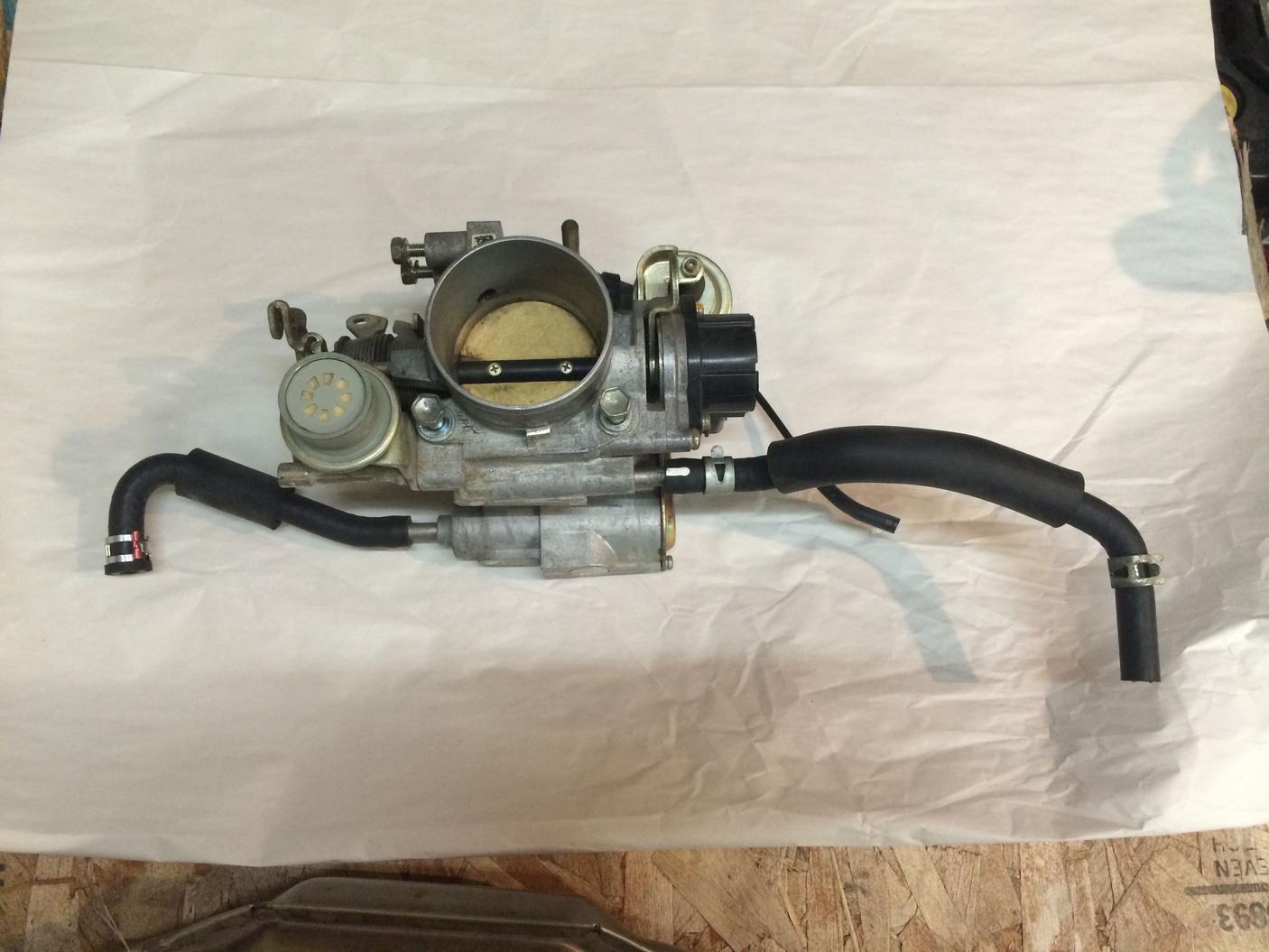

the coolant passage through your throttle body is leaking
there is a coolant path through your throttle body near there.
hose connects a vertical pipe from front of lower intake manifold, thru throttle body , to 2nd hose to bypass pipe at rear of engine.
somehow its leaking into you air passage. Throttle body has some componets on the side , kind of a tear dropped shaped stamping held by a couple screws. Probably a seal etc under that cover that is leaking.
DamnifIknow what it looks like inside, not taking mine apart , but looks like you are !
