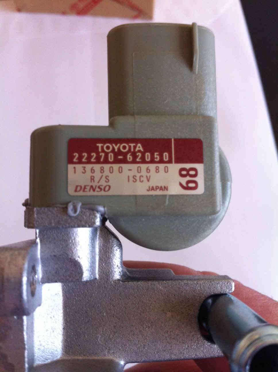

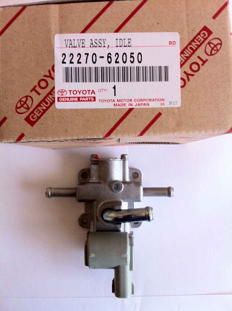

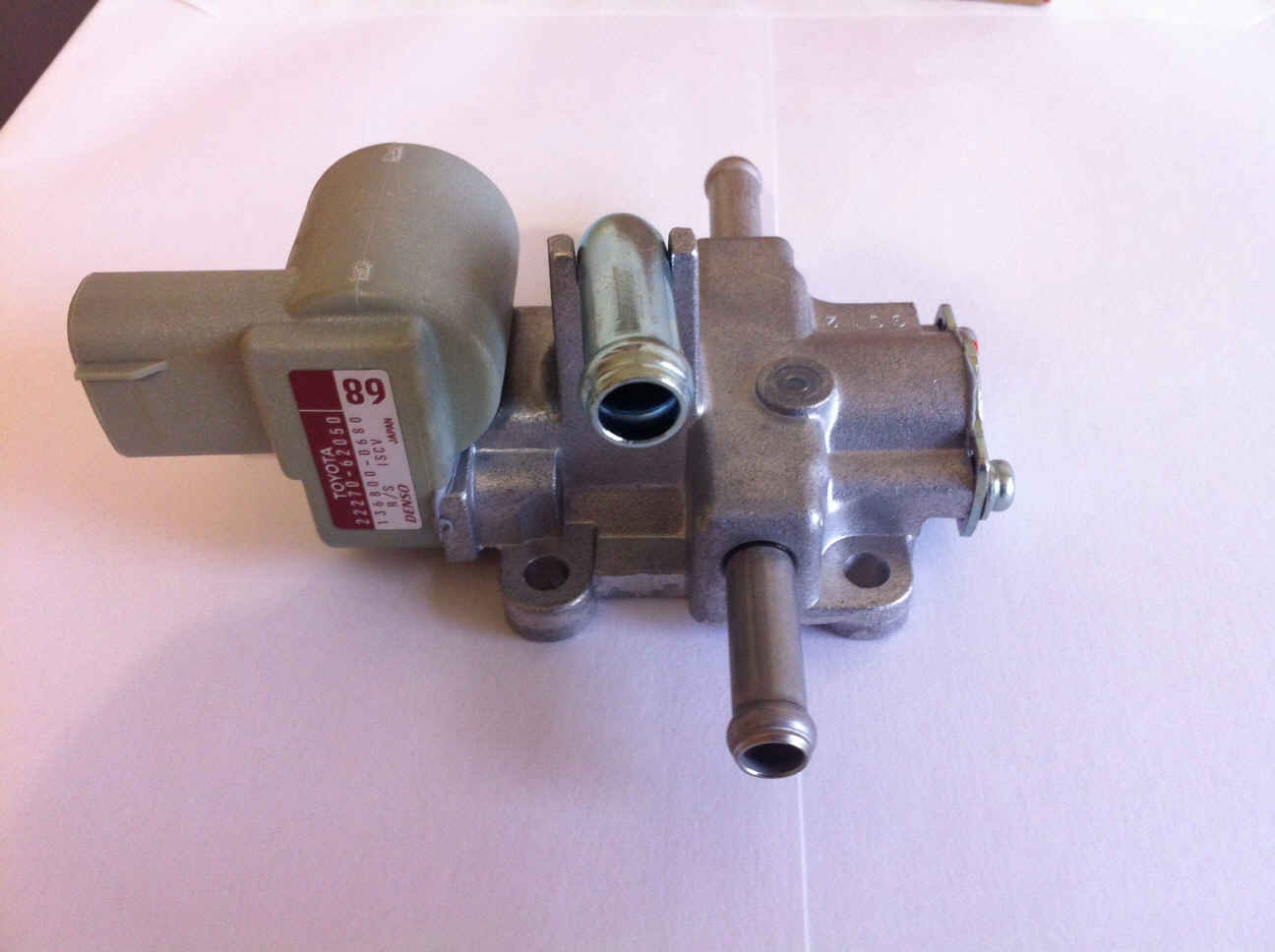

Hmmm - I'll have to get a picture of the part I purchased that's supposedly for my application. Assuming that I have an unneeded part then how are idle problems addressed - remove the TB and clean it?
These are some pictures of what I bought - its advertised as being applicable for an '02

but anyway if you do/can get them apart. the # 61087 is the correct number for the IAC gasket that goes between the item you bought above and the throttle body.
the two other items from the link is your standard throttle body gaskets that go between the TB and the upper plenum.
Mystery solved with the IAC - I went to the dealer and searched on the part number and also brought up pictures - what I purchased is applicable only up until 2001 - in 2002 the IAC is integrated into the TB.
