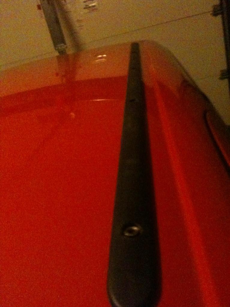

Ive got a '96 sr5, without the factory racks, but the roof has the plastic black skinny coverings, that appear to be covering the mounts for the factory track. I have thule square bars and fairing, and just need new thule feet. any suggestions on what feet to get?
I attached a photo of the roof. And the plastic cover piece. Hope that helps, I just want to use the bars i have and fairing, and find feet that fit into that area that is covered by those black slits.

Looks like you don't have the oem rack rails, and you have the rail delete filler panels. You best bet is hit up a junk yard and find some oem rails and cross bars, I have my thule moab on mounted on the oem cross bars

Well, if you want to go with the Tracker foot pack, you're going to have to get the rails from somewhere. Thule and Yakima make aftermarket solutions. These are what I ordered Thule - TP54 54" Tracks with Flare-Nut fastners
The factory rails are nearly impossible to find because the demand is so high. I live in Denver, where the market is saturated with old 4runner parts, and I came up dry on five attempts. That being said, I get Thule stuff at a severe discount, so it was a no-brainer for me to just get the Thule tracks. I'll post a thread on how it works out. I think they just mount right to the existing mount points, which is nice.
