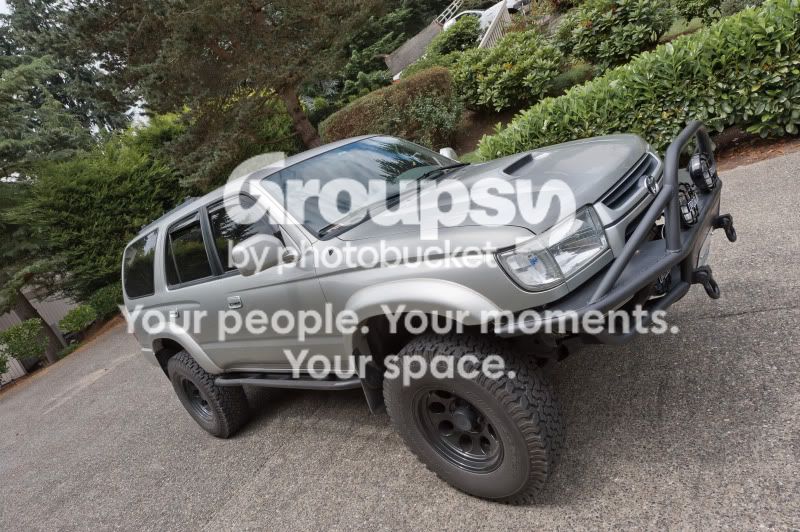

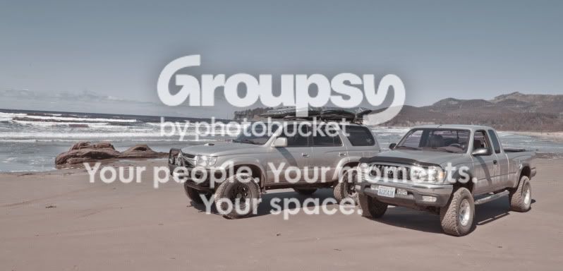

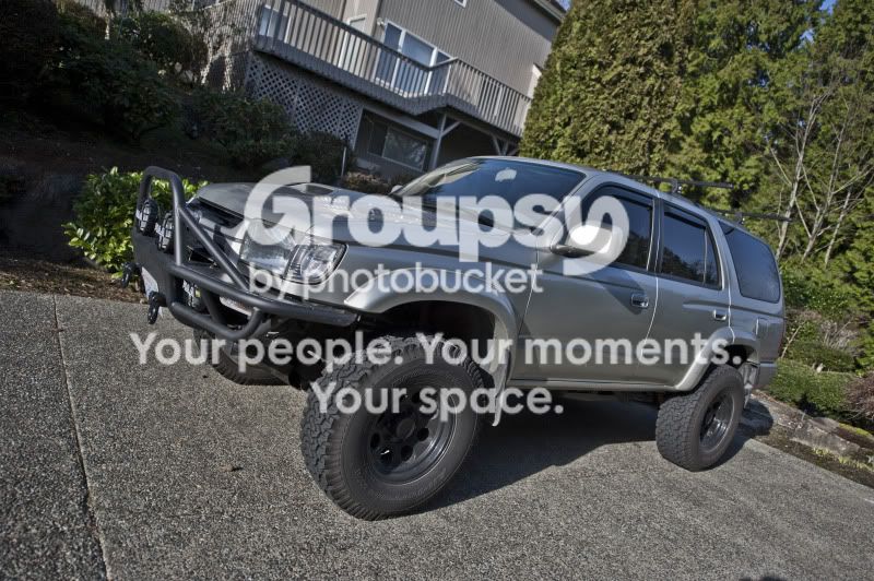

You'll want to get a set of the 430 Tracker II footpacks. They'll fit right into the factory rails. Then you just have to decide how wide of a bar you want. I went with as wide a bar as possible (65" bar. The width of the 4Runner with the wider flares is 66") so I had room to fit boards side by each and also I like to have a hanging spot for my wetsuit.
Yotas_Beach_2011.jpg~original
DSC_6059.jpg~original
Most of the time I roll with just the caps on to save on any mpg's where I can.
DSC_9614.jpg~original
Let me know if you want any different or closer pics.
