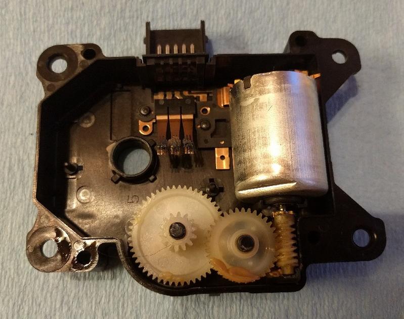

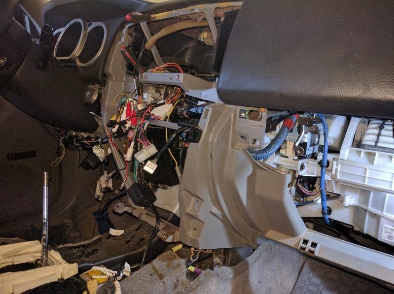

I don't know if this relevant to your issue, but I just pulled out my blower assembly to replace the upper of the two vent control servos. Out of curiosity, and perhaps a desire to make the failed servo pay for it's insubordination, I took it apart to diagnose the cause of failure.
The full motor and gear assembly pictured above didn't have any obvious signs of trouble.

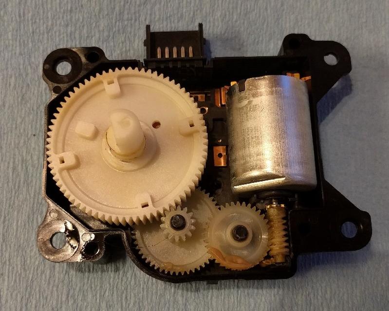

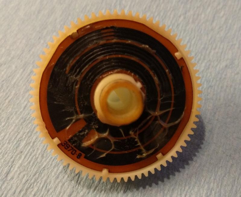

I pulled out the final gear and saw the prongs underneath. There's a circular circuit board-type insert on the bottom of the gear that has three tracks. Each of the tracks align with one of the prongs in the picture above.
The grease on the final gear shows that it rotates a total of roughly 150 degrees. On the outermost track, about 40 degrees from the farthest left rotation, it looks like the track was damaged.

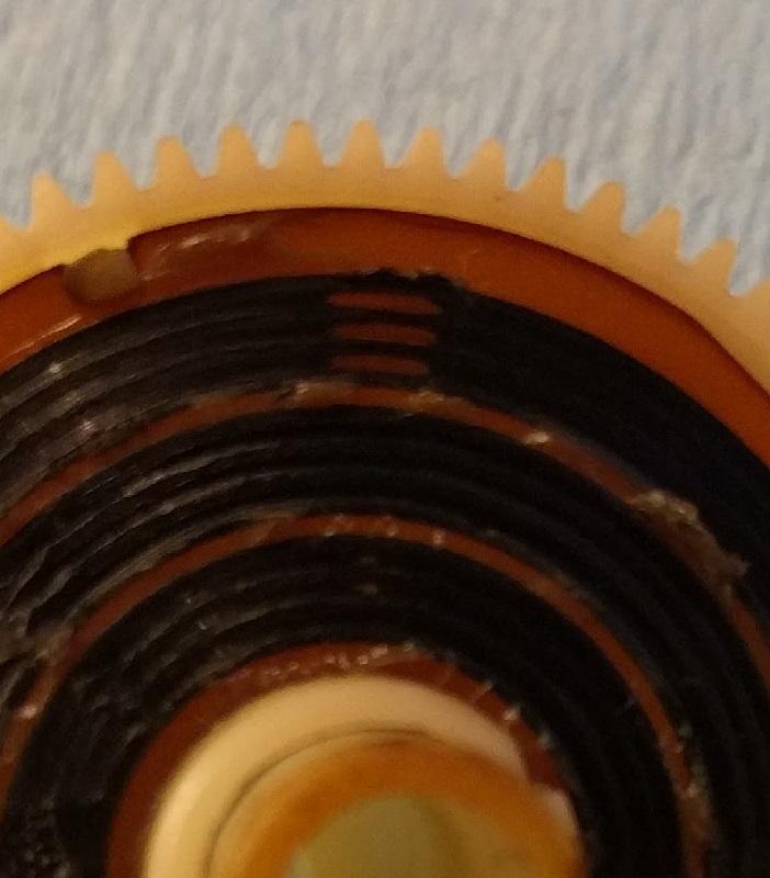

The final picture is a closeup of the damaged area. Here's where guessing completely takes over: I'm thinking that the motor would turn the final gear, the contact on the outer track would hit the damaged area and then the buzzing would start. The problem got worse over time, so perhaps the damaged area grew in size.
Good news is that replacing the servo fixed the problem and everything works again. Bad news is that I can't get the blower assembly back in place.
So a little menace of a problem has transformed into a major one, LMAO!!!!!!!!!!!!!

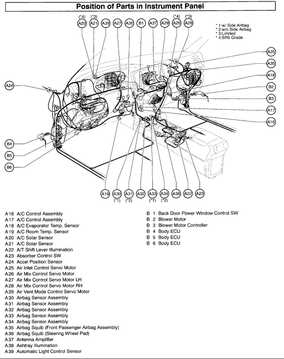

Thanks [MENTION=108082]ThirdDeviation[/MENTION] ! Do you have photos of the location of the vent control servos? From what I can tell is the sound is coming from the right of the blower fan/motor.
Did some web surfing and found this! For me the sound is coming from the passenger side, by the door and behind the blower motor. According to the diagram, it looks like I may have a bad Air Inlet Control Servo Motor. This would make sense since the sound would stop when I turn on the defroster and recirculation Hope this diagram helps everyone.

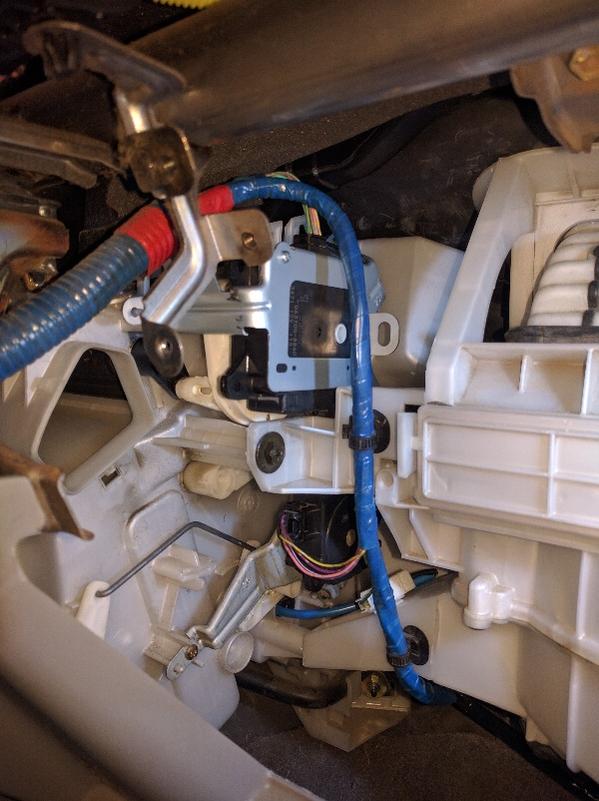

Sorry for the long delay. I do have pics of the locations.
This is the servo location relative to the rest of the dash. They're essentially just inboard of the glovebox, but up in the area where the "hidden compartment" is, rather than the main box.
The upper black box is the servo I replaced, and acts as part of the vent control system. The servo below works in tandem with the upper servo, moving when settings with defrost are selected.
As for the link from Nostromo, the proposed solution may not have done much good in my case, given the type damage to the tracks. Of course, once you have the servo out, you can check before attempting. It occurs to me that, perhaps, if the buzzing had been addressed earlier, the tracks may not have been damaged to such a degree. Unfortunately, I bought the car in this condition, and I don't know how long the servo had been buzzing prior to the purchase date.
