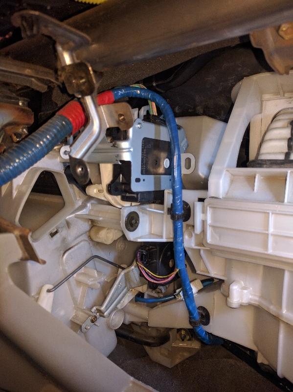

I attached a photo of the mount with the servos. Are you talking about the bottom point (very bottom of the picture)? That stupid, awful thing is a nut on the end of a mounting bolt that feels almost exactly like a screw when you're lying on your back, contorted in half, trying to a get an angle on it. And, if I remember correctly, the mount extends all the way down to that point.
Then. THEN! There is a super-hidden part of the mount just above that nut that has tabs retaining it to the vent assembly. If you don't release these, it's almost impossible to pull the assembly out. Why's that, you ask? Just below the second servo is a point where some kind of alignment pin for the mount extends something like 3 inches into the cylindrical protrusion from the vent.
So, find the clip points, separate the tabs and pull the lower part of the mount away from the vent unit - towards the opposite side of the footwell - to get it out.

[MENTION=149711]mikeisspeaking[/MENTION] Are you/did you try to pull the servo out as part of the larger bracket/mount to which it's attached, or just the bracket attached to the servo itself? To clarify, the black box has a metal mounting frame attached. That metal mounting frame is then screwed in to the larger white plastic bracket that is connected to the central venting behind the center of the dash.
I tried to remove just the metal bracket first, but found the rear screw so difficult to extract that I worried I wouldn't be able to get it back in place. Pulling the large plastic bracket took me almost as long as it took to get the servo's hidden (towards the engine bay) screw almost out, but swapping the servo and reinstalling almost no time at all, relatively.
