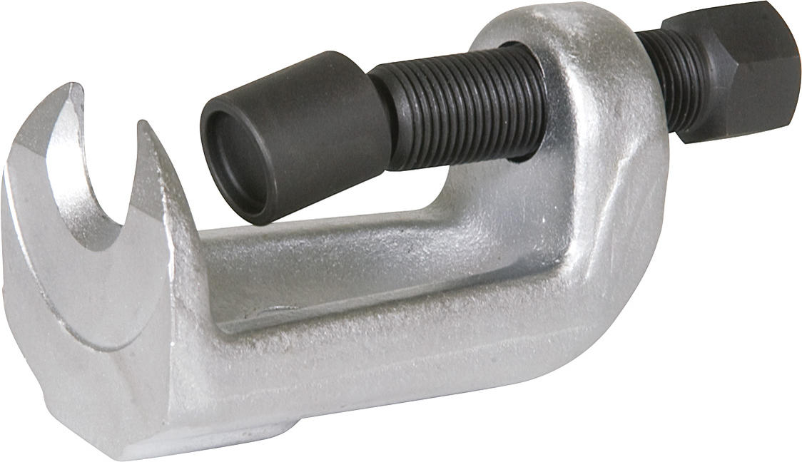

For the tie rod, use on of these guys. Autozone has them to rent for free. When they look up tie rod ends, it'll pop up as one of their tools. Another option is to thread the nut upside down and hit them with a mallet but I wouldn't recommend that for the tie rod end.
