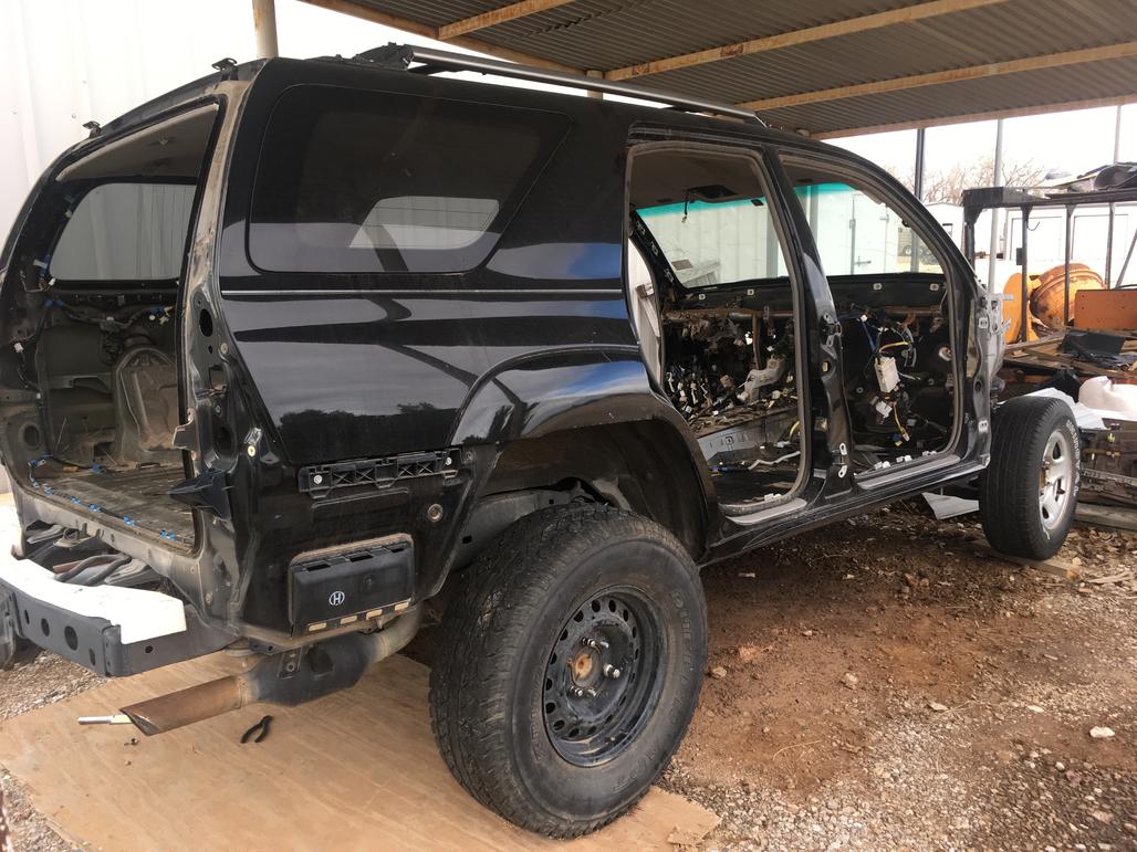

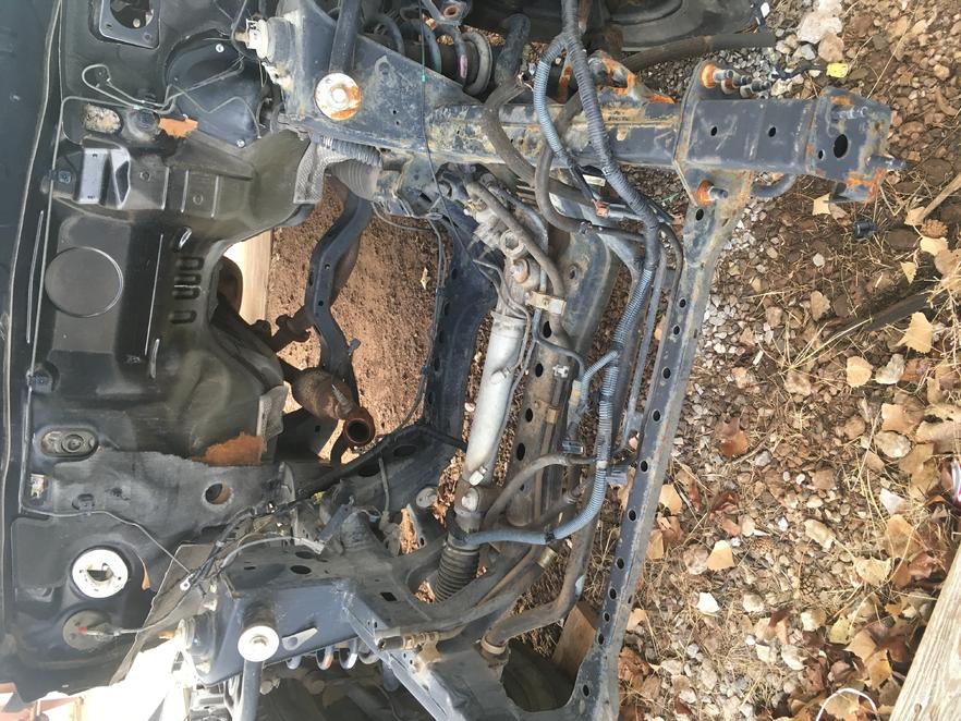

Another option would be to swap out the frame with a rust free one from Texas or Oklahoma. I have a V8 and V6 Sport. They have all the full lines, brake lines, suspension, steering rack. The V6 is perfect and has the rear-end so it could go on a two dolly. The V8 was my #1, the rear-end tube is bent and it will need to be trailered.
[MENTION=125171]rjb75[/MENTION]
I'm not sure 2WD frames will accommodate 4WD and I don't have a space to do a frame swap since I live in a condo. I'm trying to schedule an appointment at a body shop this week to inspect the frame as well as trying to find the best Toyota dealer in the area to get it inspected/possible good will replacement.
