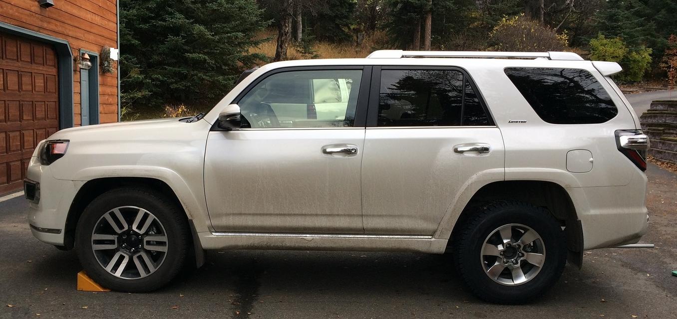

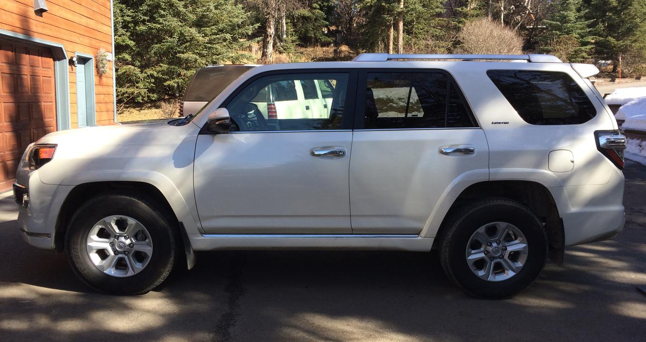

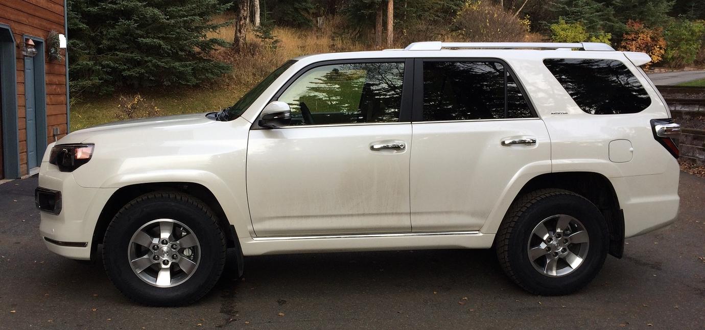

Snow is coming, time to put on the Blizzaks and put the wagon wheels away. Looks like a different truck. From LE 245/60R20 to Blizzak 265/70R17 on OEM wheels.
"Wagon wheels" - ha ha. I've got a friend with a BP Limited, and I gotta say those skinnies just don't look right to me on a 4R.
Reminds me of a body-builder with bird legs.

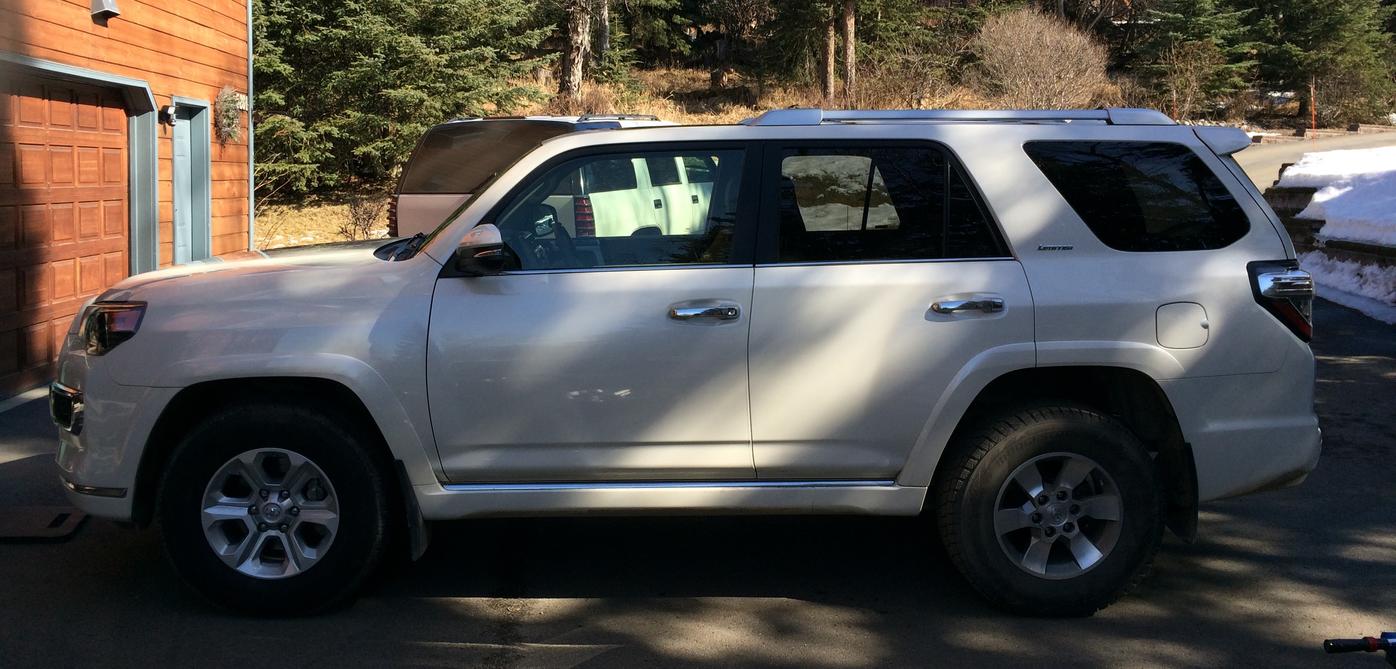

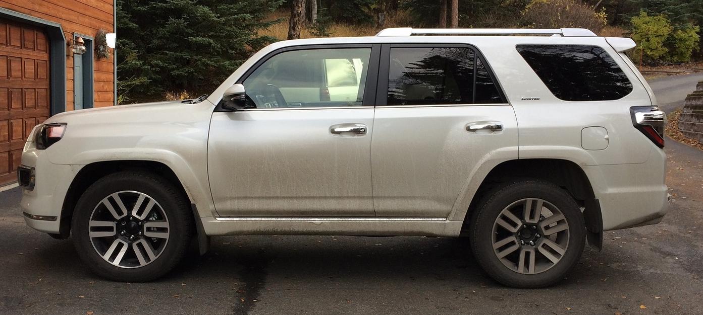

After having the 17s all winter, we decided not to go back to 20s for summer. Here are pics of swapping older SR5 wheels (winter) for the newer SR5 wheels (summer). The 20s were sold.
