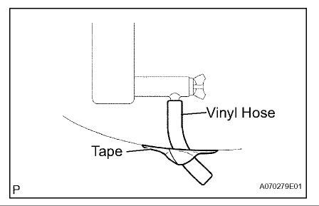

1. DRAIN ENGINE COOLANT CAUTION: To avoid the danger of being burned, do not remove the radiator cap while the engine and radiator are still hot. Thermal expansion will cause hot engine coolant and steam to blow out from the radiator.
(a) Remove the radiator cap.
(b) Remove the service hole cover from the engine under cover No. 1.
(c) Install a vinyl hose onto the drain on the radiator side.
(d) Fix the vinyl hose with tape.
(e) Loosen the 3 drain plugs on the engine and radiator, and drain the coolant.
(f) Drain the coolant from the reservoir tank.
(g) Tighten the 3 drain plugs.
Torque: 13 Nm (130 kgf/cm, 9 ft. lbs.) for the engine
(h) Remove the vinyl hose from the radiator.
