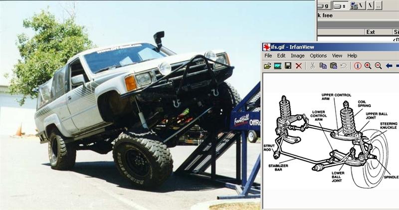

Pictures are worth a thousand words. Look how short the control arms are in the ifs. Just not as much potential for range of motion compared to the solid axle. Two wheels on the ground is better than one.

One way to think about it is this:
An IFS could be designed to give excellent articulation / suspension travel, but it would be extremely difficult to do that and also have the level of handling to match modern IFS systems. It would be a compromise at best.
And don't kid yourself when you see pics like the one above. That type of articulation doens't happen with everything connected. The first thing most guys do is disconnect / remove the sway bars, but of course the handling turns to shit.
Makes sense, yes that pic helped put it together. Stronger, and just a better platform to get articulation out of while maintaining driveability (re-connecting sway bars and the like after wheelin notwithstanding).

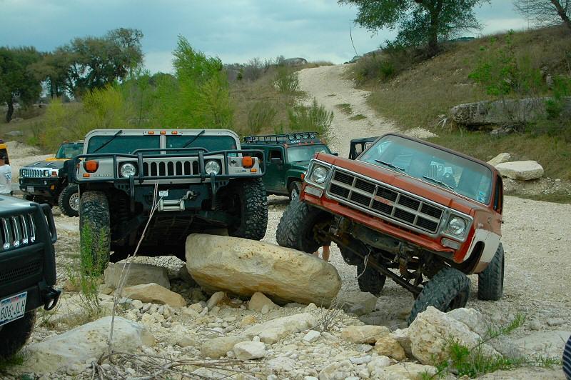

IFS would never do this
see how much flex isnt there in the front. had this been a SAS, there wouldn't be as much rear wheel lift. But IFS has advantages in speed and whoops.

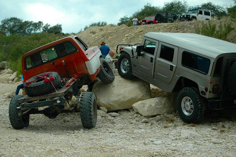

Here is an interesting pic to compare the differences: (the passenger tire on the H1 is off the ground)

I love it!
A $400 modded scrap beater takes a $100,000+ stock truck for flex. Talk about bang for your buck value.
Perfect! That's the kind of pic I would have posted if I hadn't been too lazy to track it down.:clap:
I'm surprised that this wasn't posted this being a 4Runner site and all, but here's the same 4Runner on the same obstacle, before and after a solid axle swap.
As you can see in the above pics, one of the biggest advantages with solid axles are that when one side goes up, it forces the other side down. (to the limits of articulation, of course) That works better for rock-crawling, because you can keep the tires on the ground for traction.
That won't happen in an IFS vehicle, as the wheels aren't connected together on a common beam. IFS is mostly seen in competition on desert racing trucks, since it can handle uneven dips and jumps at high-speed much better than solid axles. Plus, centerline clearance is better, since you don't have the pig hanging down. The steering setup tends to be more complicated on solid axles too.
A good set of lockers front and rear in an IFS vehicle can make up for a lot of the differences with a solid axle truck.
