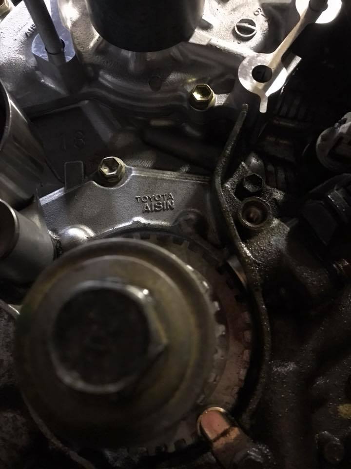

I've done a lot of work on 3.0s in Avalons/Camrys/ES300 and 330s. All of them have AISIN all over the place.
This picture is from a Camry 3.0. In addition to Aisin on the oil pump, you can also see part of it on the water pump (top left).
And yes, I know the ES330 has the 3.3L.
