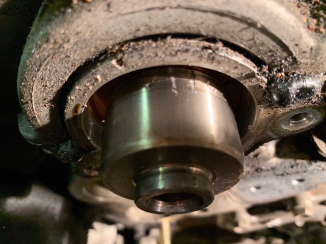

Timing belt job: I really buggered my camshaft getting seals out! JB -Weld time?
Capnemo
I have never taken engine seals out before, looked up Youtube and saw the drill/screw technique. But on the left camshaft the bit did not go straight, aborted early (I thought) and tried again. Now have four gouges on the left crankshaft surface. It looks worse in the photo but is bad enough.
I imagine the fix is JB Weld, 24 hr wait, sand with narrow strip of sandpaper
as well as can be done? Apply tiny bits of JB Weld with a toothpick? Smooth out a bit first or leave the glob to cure? Obviously I need to degrease first before applying the JB Weld.
What grade paper? 1000?
Advice appreciated...

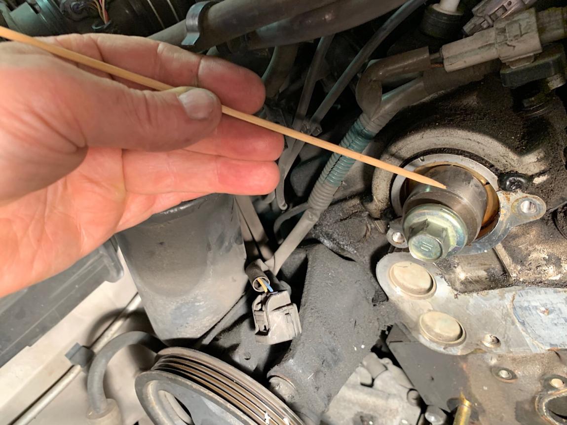

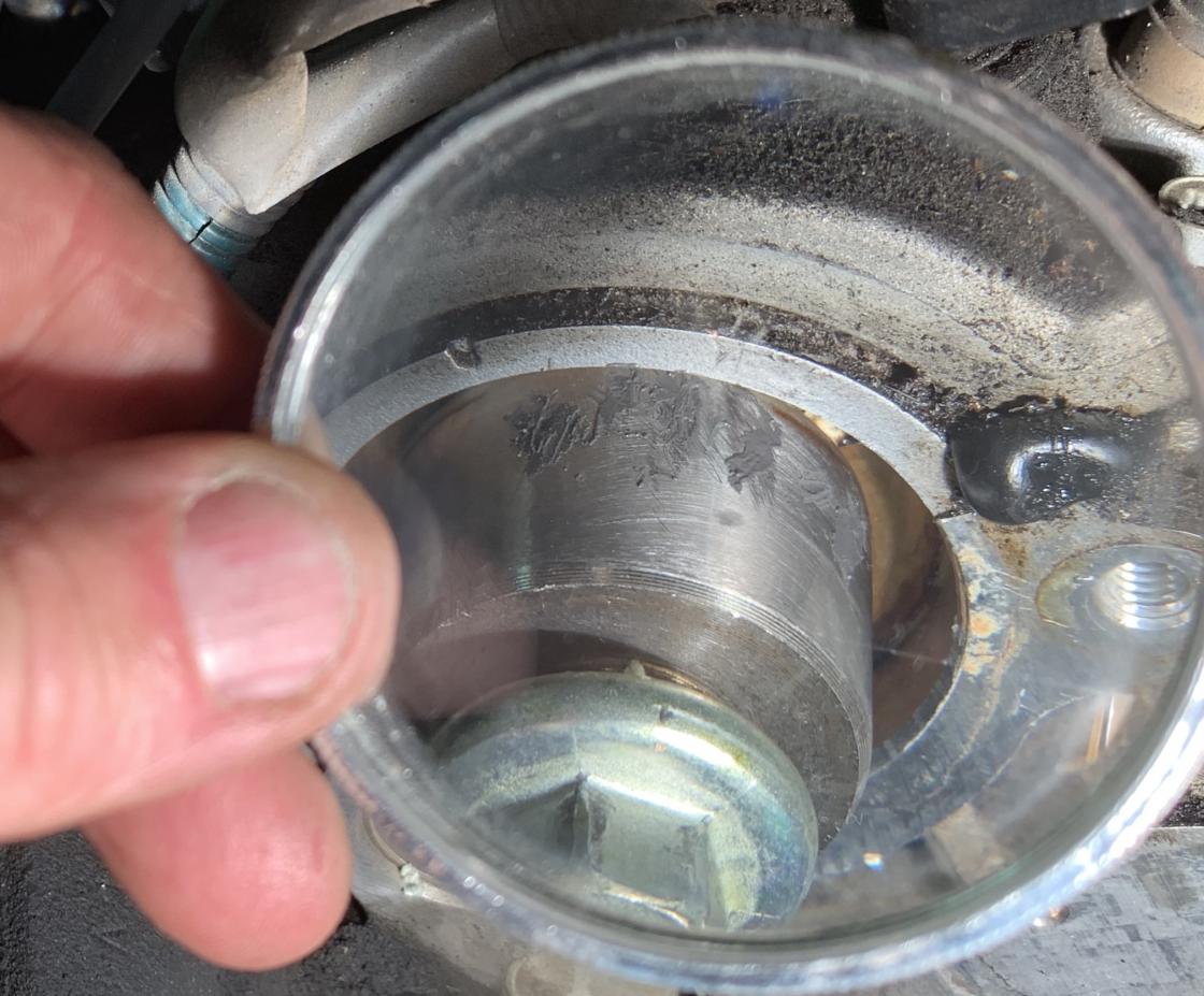

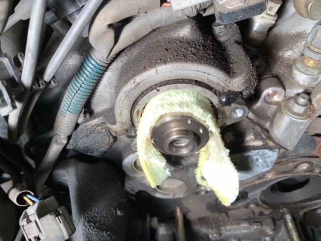

I did degrease a few more times and applied the first JB Weld, I figure if I do go ahead with the sleeve it could not hurt to fill the grooves first.
Pix of final degreasing after scuffing with 400 grit, deburred with tiny file last night. Speaking of which, after two “Vietnamese Martinis” (Bombay Sapphire East, Rossi Ex Dry Vermouth, twist of lemon) I was fired up to apply the JB Weld. Bombay Sapphire East BTW has Thai lemongrass and Vietnemese black peppercorns. Fabulous. Fortunately, I only had the kwick set variety so had to wait until today when I was sober.
Photo, degreasing
Photo, application with bamboo bbq skewer, note hand resting on power steering
reservoir for steadiness. I layered it thinly, do not mind sanding and filling any valleys on another application, better than sanding too much.
Photo after, with magnifying glass
Will post the after pix when sanded down. I have 3m double sided foam tape to bond the sandpaper to, will try to place into an appropriate sized PVC pipe to just slide over the camshaft for sanding.
