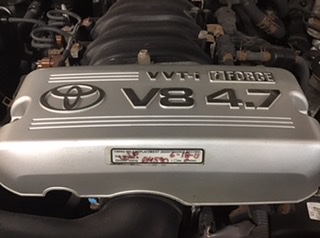

How can you tell if your timing belt has been changed? I have an 07 with no knowledge of prior maintenance.
Many service departments will put a sticker somewhere in the engine bay. When mine was done at 85,000 miles they put the sticker indicating the service, the date and the miles on the plastic engine cover. I have also seen them put on the inside of the hood.
