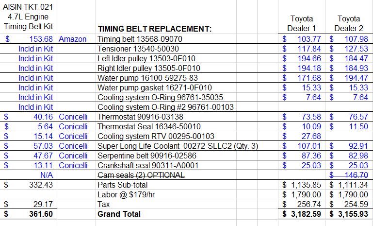

Guys, need your help with Timing Belt replacement and pricing.
I am interested in replacing the timing belt and associated recommended components. I have considered DIY and reviewed many of the videos showing the process. And even though I have done all maintenance to date myself and have never used the dealer thus far, this is one job I am thinking I would prefer to have them do.
That said, the pricing I am getting thus far is way more than I expected. I will paste below the prices from 2 local Toyota dealers as well as what I can buy the parts for on my own if I am forced to go DIY.
FYI, I am at 16yrs on the timing belt but only 45k miles. Figured I might as well do this now or in near future since this may be my only belt change needed...even if i keep this another 16 more years.
Can you please let me know:
A) Do I have all the recommended parts listed? Anything else you would do?
B) If you have had this done recently by a Toyota Dealer Service Department and paid a price you felt was fair, please share.
C) If you had 'B' done within 75 miles of NYC and had a good experience please share the dealer info, I will go there for a quote.
D) Is this really a 10 hour job for a Toyota certified mechanic?
Thank you!

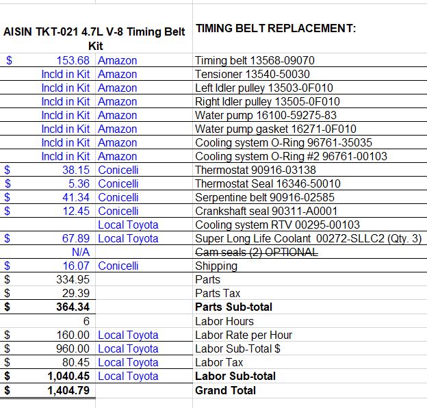

Thanks for all the advice, feedback, PM's, etc. I did watch those vids and do think this is something that should be doable. But this is just one job I think i just want to leave to a certified pro who has done many of these in the past. The sunk labor cost is sort of an insurance policy that if anything goes wrong, Toyota is responsible for it kind of thing. And if something goes wrong here with this being an interference engine, the cost would be very high even though the likelihood of a mishap may be low.
That said, I went to 5 Toyota Service Departments in my area and out of them all found only one that seemed very fair on both the labor hours as well as rate. Most importantly the one I chose has no issue at all if I bring my own parts, which is a major savings. Also, they will give me a loner vehicle (4R or Rav4) for that day!
Their quote for parts alone was $1230. I purchased everything needed from Amazon (AISIN TKT-021) + Conicelli Online Toyota Parts for a total of $365 including shipping and tax. Please note my original chart above had the incorrect part # for the Serpentine belt...it should be 90916-02585 for a 2007 V8 4Runner. I think the part number i originally listed was for non-VVTI engines.
Labor quote was 6 hours @ 160/hr. = $960.
So total $1400 OTD, which is a total price right around what I was originally hoping for and a big difference from the $3100+ I received from the first two places i went to.

The two local dealers, both of which I have purchased new vehicles from in the past, are $179/hr. One quoted 10hrs labor, the other 11 for this job.
The Toyota dealer in the Bronx was $220/hr (8 hours quote for this job) and the Manhattan dealer didnt even call me back after taking down lots of info on the job and vehicle.
