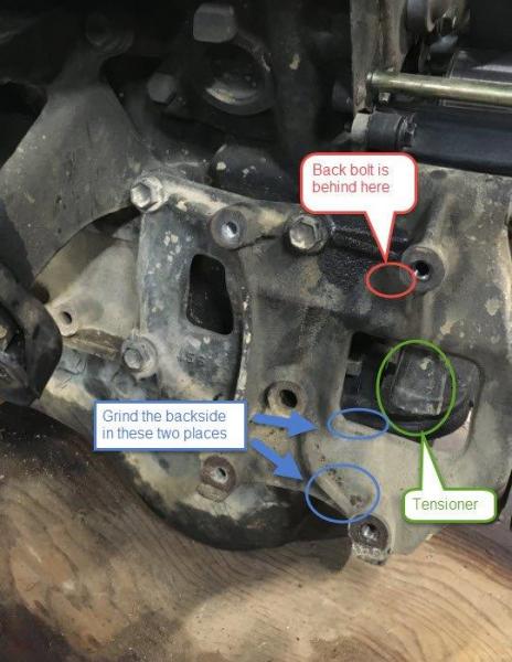

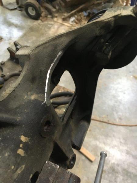

You only have to do that once. When you get the bracket off, hold it in place and look at where the underside of the bracket gets in the way of putting a socket on an extension between the oil pan lip and the bracket and onto the back tensioner bolt. Then grind out half moon areas of the two webbing areas that are in the way. You don't have to grind much, maybe 1/4". Then paint and install.
[/IMG]
