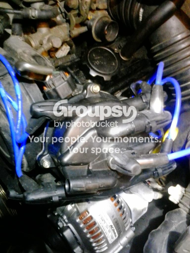

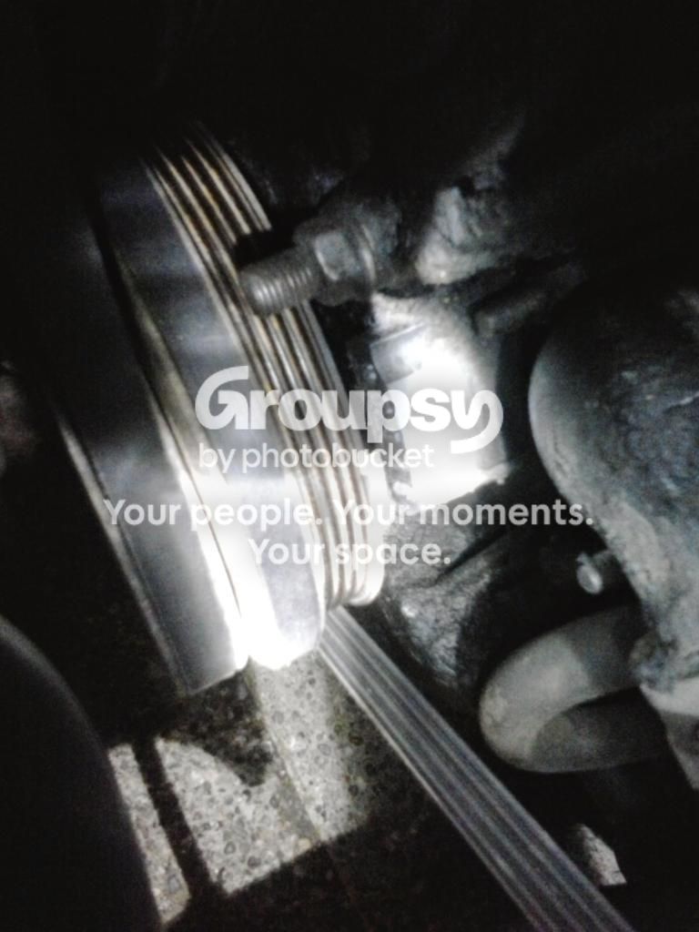

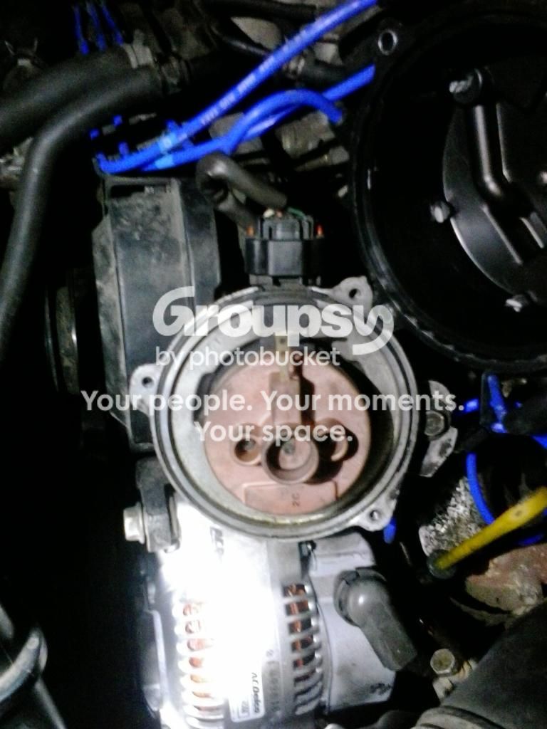

I took some pics and video...
IMG_20150114_185309.jpg~original
With cylinder 1 at TDC
IMG_20150114_184038.jpg~original
The plug wires was off to put the bolt back into the cap.
IMG_20150114_184023.jpg~original
Its hard to see but that is a the timing mark at 0 TDC
I believe that it needs to be more at 1 o'clock and not 12. Don't quote me tho. Take a pic of the inside of the cap
Just a thought... The PO had some other type of cap on it that kina fit but we replaced it with the propper one. (Only 2 of the mounting holes lined up) Could the rotor be wrong too and not work with the new cap? Weird thing is, it ran before with the new cap but 180 degrees out.
I will see if I can get a pic of the inside of the cap.
