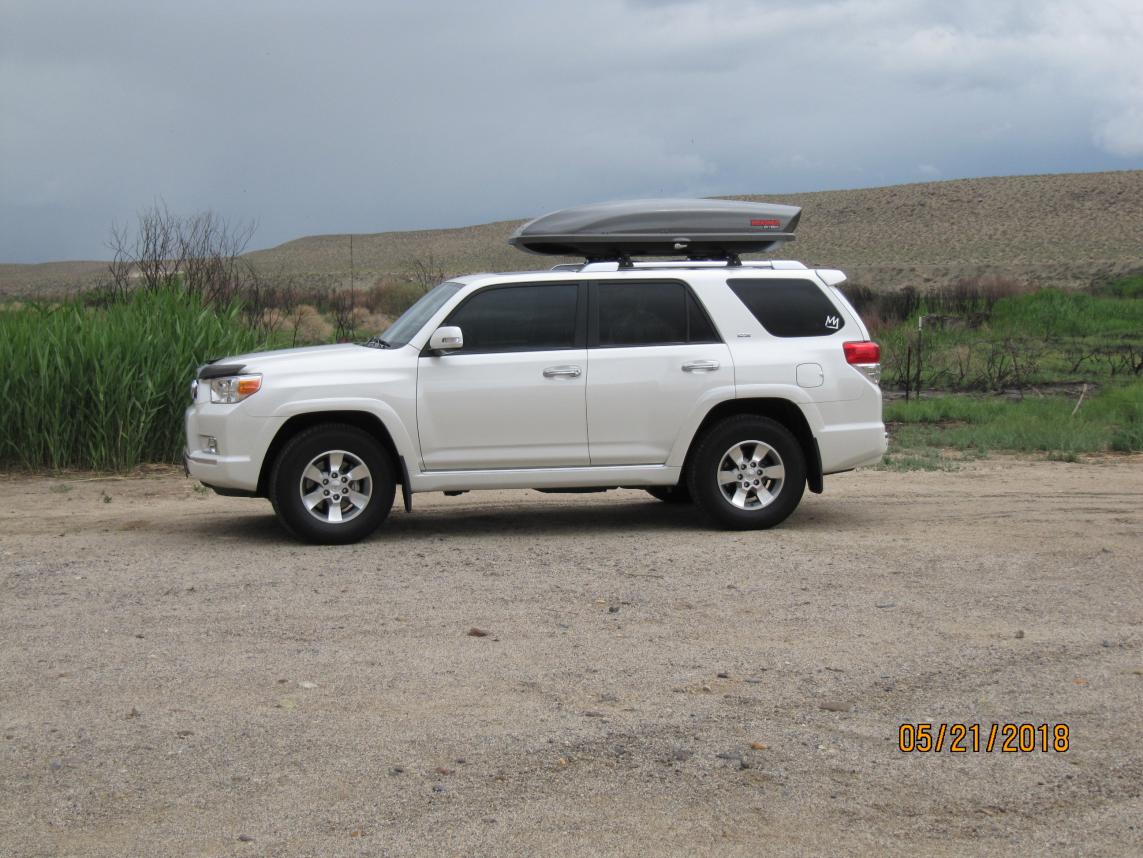

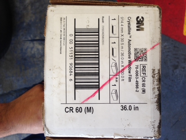

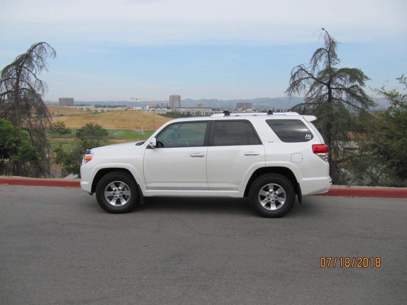

Here is the 3M crystalline CR 60
It cuts the heat but not the glare, early mornings on the north bound I-15 can be bright, My wife has a pull down shade that solves this.
I had to removed my pervious tint on the DS &PS Thanks to the CHP looking for an excuse to pull me over. It was just a fix-it ticket.
Rather than risk another ticket ( which would have been a fine) I reduced the percentage. It doesn't look as cool.
Sorry the Phot is upside down

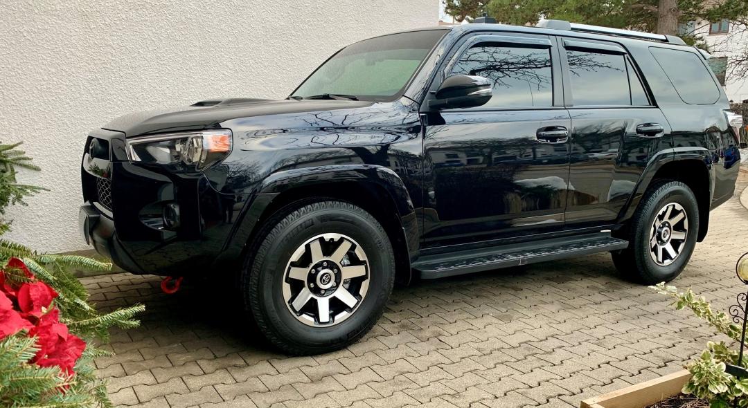

A quality tinter can match your windows.
As others have said. Your state law will dictate what you can do.
I have ceramic. Measured 11%. (Window tint exempted documents)
I also have LED Back up lights to aid me when backing because of the dark tint.
That’s another option depending on how dark you go.

It’s good you got your exemption, it’s too bad you have to jump through so many hoops to get it.
Do you have to display a window decal also?
Yes we do, it’s an ugly orange sticker above my inspection sticker on my windshield.
Not shown in any current photos, yet.

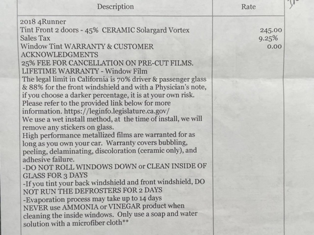

For OP [MENTION=615021]pull4adv[/MENTION] take a look at this website for state tint laws. For CA they are more stringent. You could get your fronts to match the VLT of the rears, and since the windshield lets in so much light, from the side they will look lighter.
I found my receipt from a Mr Tint in the SFBay Area for an example to consider.
California tint laws:
California Window Tint Laws 2021 Explained - Windowtintlaws.us
How to get tint medical exemptions:
How To Get Medical Exemption For Window Tint - All 50 states

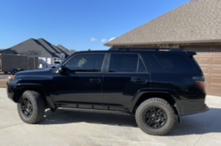

Cops in these parts run around with tint meters. They generally frown on anything below 30%, tint on any part of windshield, tinted plates all that stuff. I installed 20% all around but there’s enough overhead light through the sunroof glass and windshield which makes that level just fine when seen from the outside.
I put tint across the top of the windshield too, helps a lot I find. The factory tint was way too light out back for me... adding tint made it just right for headlight glare at night. No issues seeing out but my night vision is good still.
Unless you’re attracting attention coppers are typically too busy. But if you choose to put a coffee can on your tailpipe it’s a sure thing to get stopped around here and out come their gadgets. I’m sure most PD’s have the same.
Measure at 5% (meaning 95% of light blocked out).
I have the windshield at 50% with limo banner strip
Front windows at 20%
And limo tint on the rest.
Hard to tell from pictures in the garage. Thank god for led reverse lights and the back up camera otherwise I couldn’t see shit !
For me I went a little darker than what came from the dealer in the back half. The front driver and passenger I went as dark as legal in Texas. This was all done with ceramic. I had the front done with the 3M crystalline, virtually clear. No one has noticed I have it on there.
All this helped immensely as before I would run the A/C almost full blast to keep cool. I hated the noise the most. Now I don't have to do that. The downside is that the glare is worse inside, but not really a distraction. The 3M film was scratched when I removed the headliner, so you just have to be cautious, but not saying you have to baby the front window either.
Keep in mind, the inside will still get hot when sitting outside in the sun, but I notice I can touch the steering wheel without feeling like I am going to get burned. In the end, well worth it, especially in the heat of the summer.
Thats insane. I defintely would not be able to drive that at night. lol Nice rig! Defintely getting some LED lights.
So it this 20% tint all around with the sunroof open?
Defintely need to get LEDS....everywhere! Nice ride!
Thanks for the input!

Yes the sunroof shade was open, truck was facing the light coming through the garage etc., its subjective obviously everything depends on what angle you're viewing the vehicle at. Black interior doesn't help much either so 20% film may be way too dark for some folks all around, I'm just saying that on a sunny day there is enough light coming through the glass in the vehicle where from a side glance - a law enforcement officer can clearly see a person to distinguish gender, if you have a belt on etc.
But throw in a bit of overcast and a different angle and sure - it will look as black from the sideview reflection as the same film applied over the factory tint. The reason I applied film over the factory tint of course wasn't really to darken it more it is to match the same pigment looking out during the day. I hate looking through one shade/color of glass on either side of me and a different type out back regardless if they are approx the same tint level if that makes sense... polarized glasses seem to make that worse, so that is my reason for applying film all around on the vehicles I've owned...
