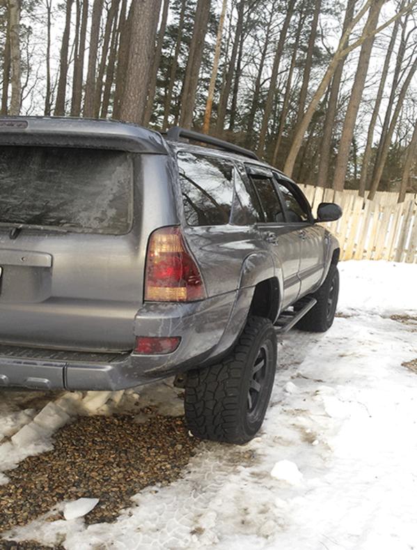

Guys its not all that bad like your making it out to be. Yes there are some people that take it to far but here you can clearly see (all though the truck is dirty) all three of the lens covers for the rear of my truck have been tinted. The spoiler and bumper reflector have three coats of transparent black and the tail lights have two coats. I sprayed them with transparent Axalta black paint and clear coated them. Never had a problem. If you want to do it than do it, just be aware of what the others have warned and keep it minimal.

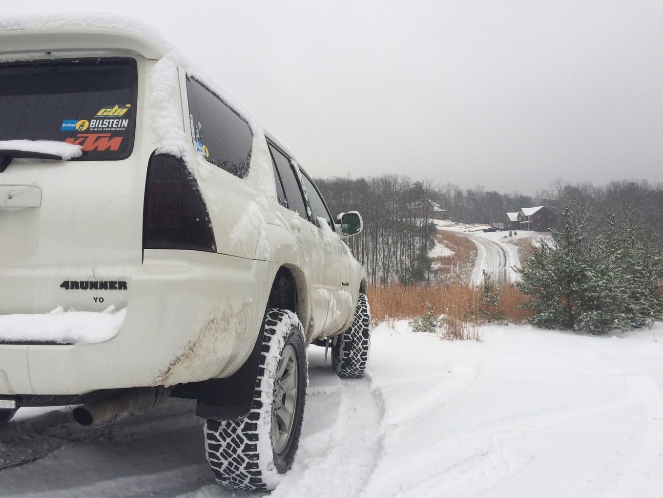

The trick is to go heavier in the spots where there is no light output (outside edge, between bulbs, etc.) to achieve the shadow effect. Mine looked very dark when not on, but in the daylight, they looked more like a smoked red. LEDs and thin layers strategically applied are the only way to do it right IMO. :thumb:
My previous T4R -->

I like that white 4Runner. Looked at lights today on eBay and cooler ones were close to $200. I'll talk to the tint guys and see what options they have I know the film they have is a 20% and 35% tint.

SO they look clear i don't really see a tint to them so what exactly is the point then? I don't think there is really anything that can be said justifying tinting two lights that are the only thing keeping one from taking one up the ass from another car or truck.
SO you tinted it, it looks clear then why bother if there wasn't a change? or you tint them to dark and still whats the point. to each is there own i guess. Honestly i think this is a mod that is done because its winter and people are bored as hell.
IMO there are to many cons for anyone to do this. No one walks up to a car and say DAMMMMMM those are badass tail lights. Then again i look at it another reason to be pulled over which i don't have time for. Cool kid factor vs safety.

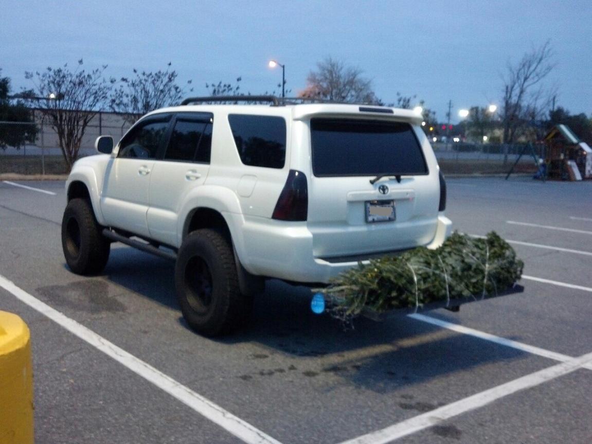

I have 4 light coats of vht nightshades on mine. They are still very visible in all lighting conditions. As you can see from the pic, they are still see through up close, but far away they look completely black

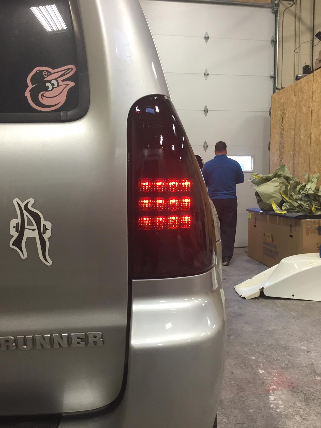

Hey fellas ended up getting my tail lights painted instead of tinted. They put film over my light and I couldn't see the bulbs at all with the paint you can still see the Bulbs through the black. I had a cop behind me for about 5 miles last night and had no issues
