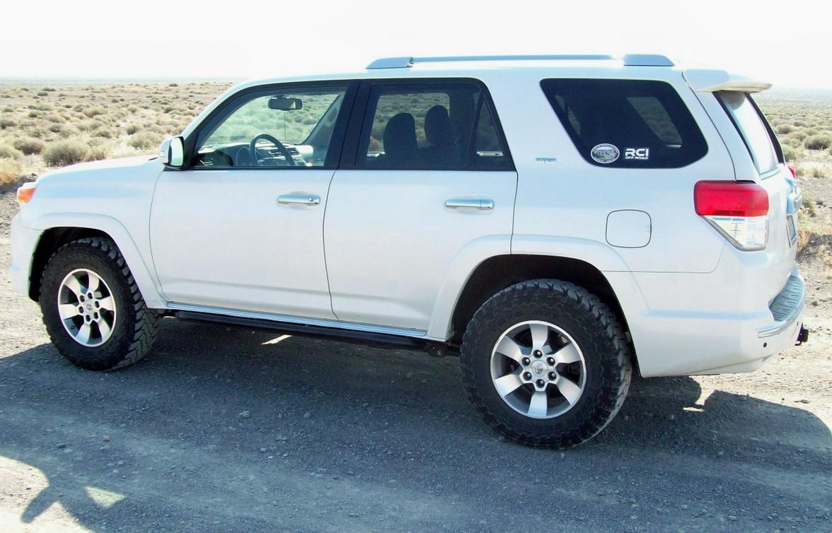

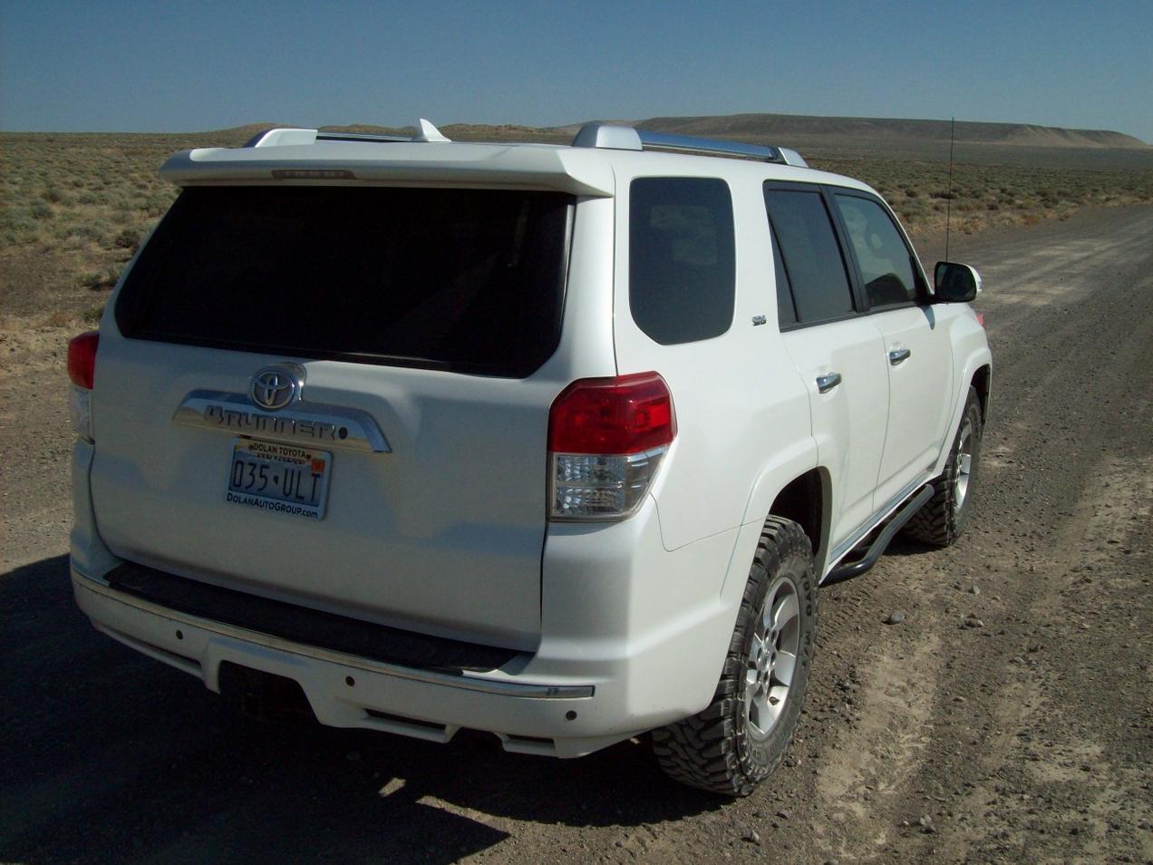

My RCI's are steel - I painted them with Rustoleum (BLACK). I have what's left of the SR5 plastic sills just above them (a bit of white with chrome strip) Looks good. Will probably give them a bit more rustoleum a couple times a year.
