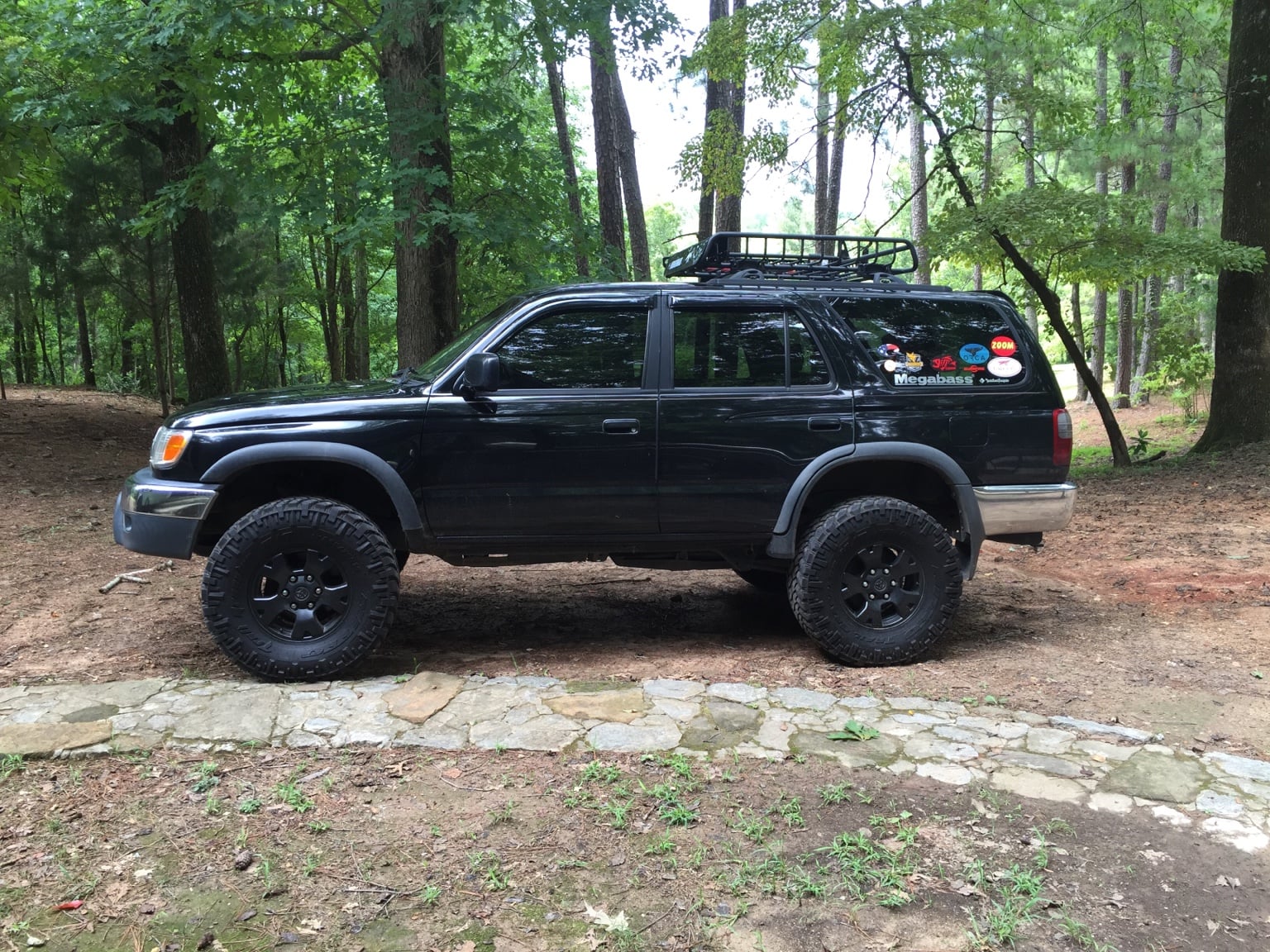

My wheels are off of a Tacoma but not sure if these are the ones you're looking at. However these fit just fine.
All the newer (2005+ tacoma, 2003+ 4runner) wheels have much more backspacing than a 3rd gen. They'll usually fit fine with 265 tires, but if running a larger tire (285, 305 or 315), they will probably need wheel spacers or aftermarket UCA's (or maybe both) to clear.
I had a set of 17" taco/4R "sport" wheels with 315/70r17 BFGs (which run small) and they would not clear the UCA even with a 1.25" spacer. Just something to keep in mind.
3" lift on 285s. Honestly I think the tires fit the lift perfectly. I'm going bigger when I get the opportunity. Also I'm running 1.25" spidertrax wheel spacers.
I would like to get about that balance with 265/75/16s. Still sorting out all my details before I pull the trigger on the lift.
