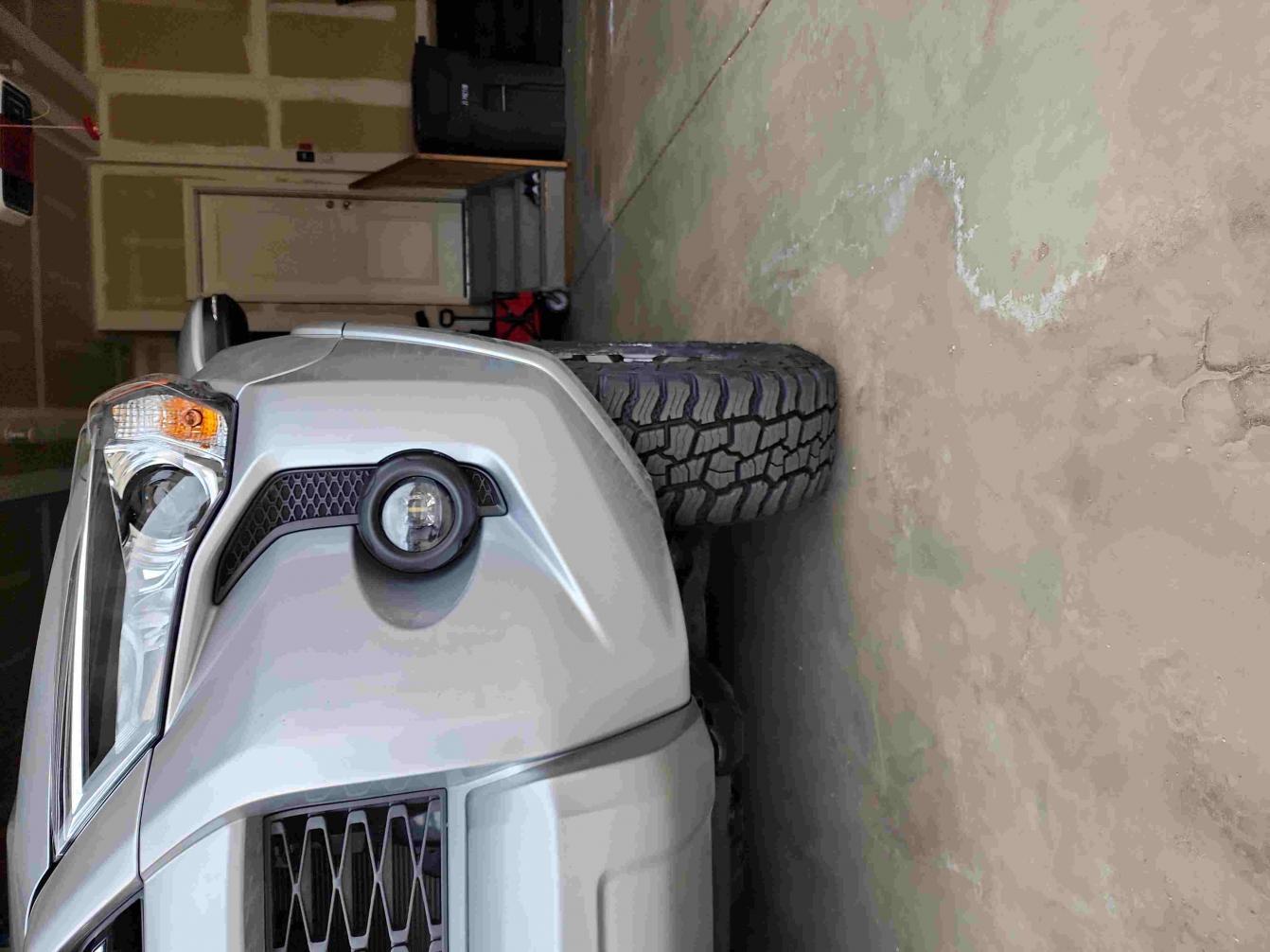

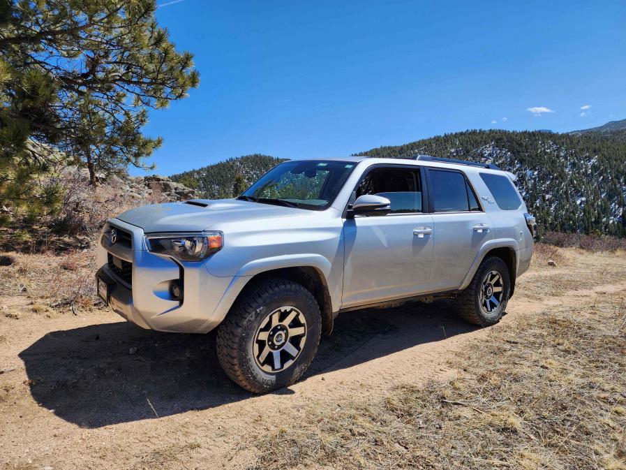

I went through the same thought process you are going though. I ended up with the M/T baja a/t and so far I am liking them. I was torn between the KO2, Falkens, and Baja. After checking the weights, reviews, and my own experience with KO2 I went with the Baja a/t.
So far I've had the XL rated for my daily driver and some highway driving (about 600 miles) and love them. Have driven in light snow, some wet roads and one mild trail that I did almost completely in 2 wheel drive.
I did go with 265/70/17.
