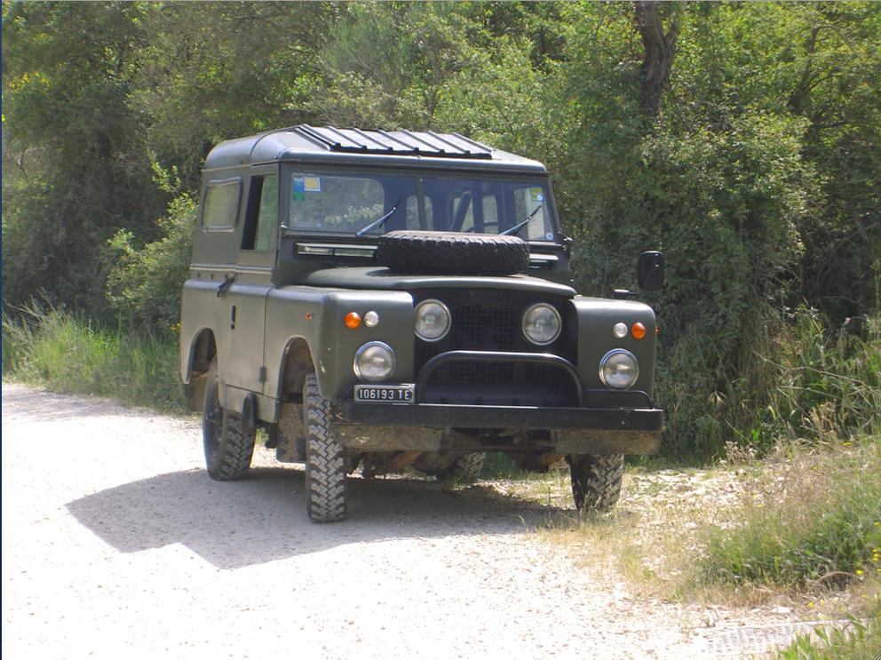

i guess i wasnt clear, i meant that offroading is for skinny tires, wide tires have a purpose of rock crawling only. im not a fan of wide tires. i love series rovers and if you notice what they ride on, they ride on pizzia cutters compared to modern tire sizes. i completly agree agree with that thread you posted, i feel wide tires are useless in most any situation. sorry for any misleading.

Yeah, I've seen some Rovers with 235's and they looked great. This size has been my favorite thus far and can't wait to get some 255/85's.
