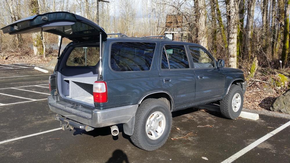

That's the 235/85R16:
just for fun, metric tires sizes are so fun!
235 = 235 mm width (~9.25 inches wide)
85 = 85% of that width is the sidewall height (0.85 * 9.25 = 7.86). Add the 16 and two sidewall heights 16" + 2(7.86) = 31.72
16 = 16 inch rim.

The 235/85:16's on my truck (studded snow tires) are 32" tall. But load range E. Which you don't like. On a 6" wide rim.
