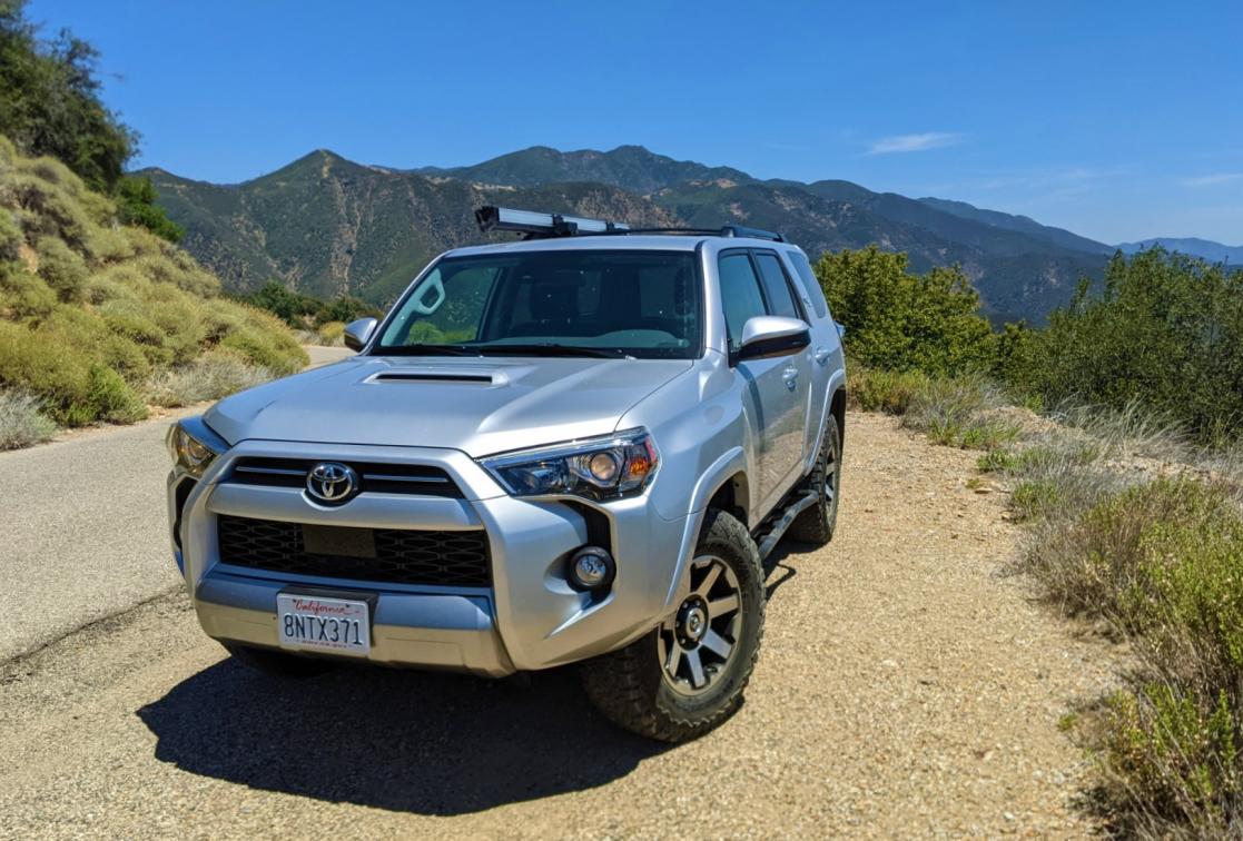

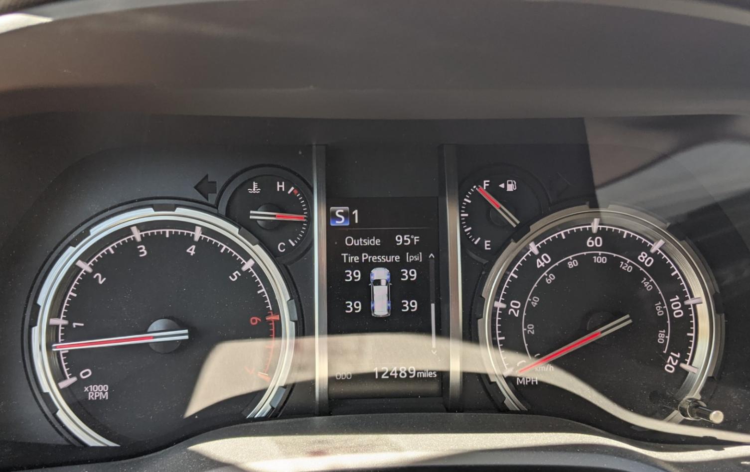

I purchased stock size KO2's last week and 35 was suggested at the shop, so I made sure to accurately set them the next morning to 35. I remember seeing a post suggesting BFG stated 40psi to a question for a 4Runner using the c-rated tire. I have tended to make my adjustments based upon tire expansion when up to temp as a guide seeking 10-15% expansion/increase in pressure. There is also the temp variations and elevation but just seeking a balance of factors.
Today it was fogged in and 60 degrees on the coast at sea level. Drove 20 miles inland at 55-60 mph with temps approaching 80. Pressure after a dfew miles at speed was 38 on each wheel. Increased in temps to near 100 degrees on Figueroa Mt. and tires reach 39. A long downhill under braking tires reach 40 and at the very bottom, the rears at 41. In time and back at 55-60 mph in 80 degree temps and lower elevation tires settled at 39 and back on the 101 on the coast at highway speeds one dropped to 38.
So 35 seems to ride well and maybe loaded will bump them up but 35-37 seems a good start for me.
