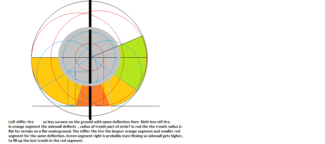

Lately adjusted my spreadsheet, so I can make lists with in front of psi other calculation then behind.
For the RV world use that for single and duall load.
But made a mistake so front calculation used parts of rear data.
I saw that when calculating back your 80psi, must be 90% from 2x 3197lbs= 5754lbs and not 5770 lbs.
Repaired it and saw that difference was that small, that I dont need to make a new list.
But can also make list with for instance in front for same sise P-tire, and behind E-load.
Then you see that LT has lower loadcapacity for the same pressure.
My idea is that LT has lesser surface on the ground at the same deflection then P-tire, so lesser lbs to carry. See paint-image I made long ago.
Found the topic about this began in 2012, last answer 2021. I it usefull to react there about this and more?
Or is that topic not actual anymore?
It's partially that and partially LT tires has more structural material, which when flexing at the same extent as P tires, can generate much more heat.
So then part is more heatproduction at same deflection for LT. And part is lesser sufacelength so surface on the ground wich gives lower loadcapacity at same pressure. But smaller surface on the ground gives a bit less heatproduction of the treath, wich then compensates it a little.
Newer material and construction of nowadays tires make them give more surfacelength on ground.
And lesser heatproduction.
Then you could calculate an E-load tire as if a D-load tire so smaller difference in pressure for the load.
