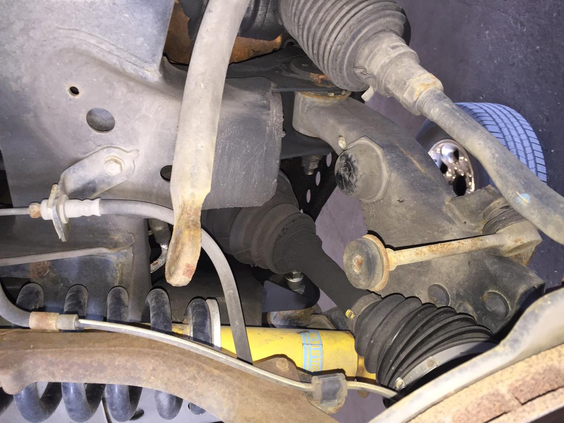

Got it. Thanks. Done and then we found this.
BOTH are busted. What are you guys using for good replacements. Non lifted truck.

OP you don't need anything special for those sway bar links. You're local auto parts stores have them or can get them easily or go with Amazon or Rock Auto if you prefer online.

If you dont have a lift use OEM.
Absolutely no reason to pay OEM price for this part--the OEM link is nothing special. This part works until it breaks; there is no 'performance' difference. The Autozone link I put on at 85K was just as beefy and has lasted longer than the factory one. Give me one good reason to pay $108 list or $75 on-line for a part that costs like $25 at Autozone or $14 on Amazon. There is no risk to a part failure, I never noticed mine were broken until I happened to be under there and I really think the OEM are pretty cheesy.
They ain't LBJs. That's a different story.
Mine are 16 years old & never broke. I've seen people on here break crappy moog ones in under a year. There's your one reason.

I've broken cheap links first time I flexed out on stock suspension. Oem links on these are not much better. Spot welded two piece design that fails. Tundra front links work and they are a entire casted piece of metal that is a lot stronger. You can find cast Tundra after markets also to save money but the super cheap ones will be two piece spot welded.
