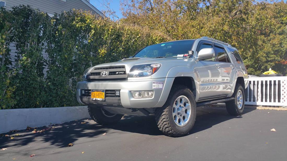

I run 255/75/17's in BFG mud terrains, they were jeep rubicon take off's. (can be found very jeep for brand new tires)
I have the daystar 2.5" spacers installed. I had to remove the front mud flaps which takes all of 2 seconds. Otherwise even during off roading it does not rub at all. MPG only took a small almost unnoticeable hit if any at all.
Speedo is also only off slightly, but as stated earlier, the faster you go the higher the speedo is off. I think ride quality improves with taller sidewalls but cornering performance takes a small hit depending on the tires you go with, not that it matters since you drive a truck not a sports car. Its a great size upgrade all around for a mostly stock vehicle and there really is no downside.
