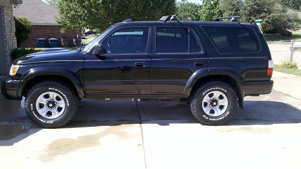

Or you could do a 2" BL or higher and get 255/85/16 tires which would be like 33x10.50'sx15s. That would give you the cookie cutter look others mention and they shouldn't rub the UCA's. That should get you over the river/mountains and through the woods/mud in TN or NC whichever one you wheel in. Here is a pick of mine stock suspension, no BL on 265's.
