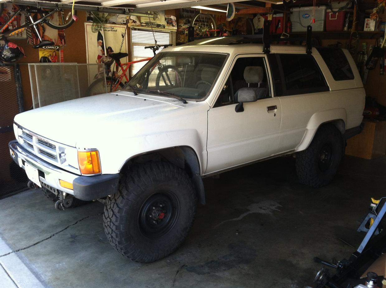

I'm running 33/10s on the original 15x6" rims. Zero lift, zero rub. Pinch weld mod only.
But I bet if you went and looked, you don't have another 1.25" room between the tire and a-arm to fit a 33/12.5?
Also, clearance will get worse if he adds a BJ spacer in the future which is the more cost effective way to get a decent lift.
