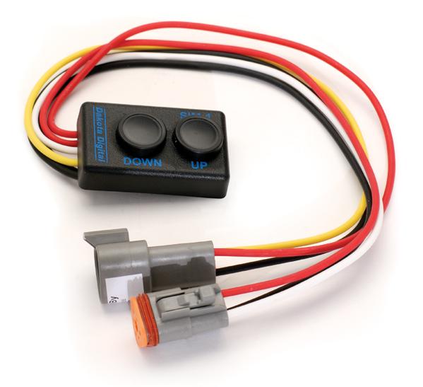

Also when I get the 33" tires on, the speedometer is going to read a 15% difference. How do I go about recaliberating it? Is there kits that I can use or what?

anyway, as for your speedo, you cant really recalibrate it... what you should do is if you have access to a GPS device, ride with it on and see what the actual MPH difference is. then just bear it in mind.

Actualy yes you can recalibrate it. www.DakotaDigital.com
Electronic Speedometer Adjustment Module $109.95
