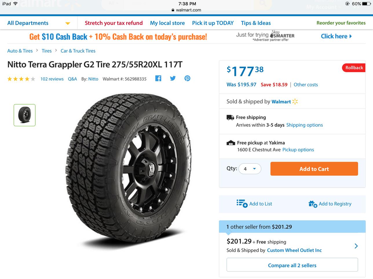

Nitto Terra Grappler G2 Tires
HELP!!!!! I have a 2015 Limited 4 Runner and wanting to put Nitto Terra Grappler G2 Tires on. I'm wanting to put these tires on my stock rims. Will this size fit the runner without any modifications?? 275/55/20???? Thanks!

yes it will. very slight chance you might rub turning into parking spot ect. but you should be more then fine

I had the put on today and they rubbed against the plastic inside wheel well. The only tire that rubbed was the driver side all other tires were fine. Damn!!!! At a lost but all I need to do is modify the plastic so the tire doesn't make contact. Any ideas????

strange. I have put several sets on for customers in that size with no problems what so ever. If it is just the plastic there is a few things you can do.. you can get a heat gun warm it up really good then push it back and spray with water to cool it. that will reform it back further. you can cut what you need out a lot of the time with a good knife or you can poke a hole in it get a zip tire and find a place to suck it back further.
