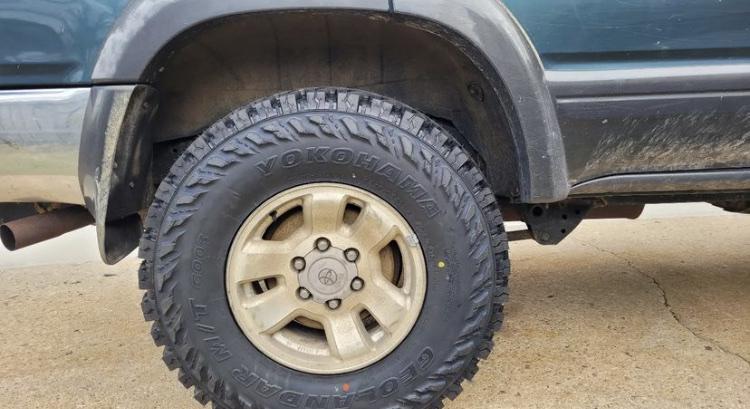

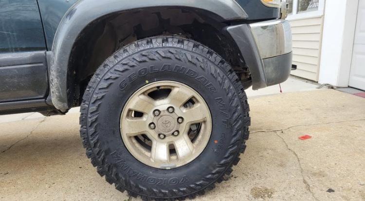

I’m running 255/85/16s which is the same size but more sidewall. Not only does it make the steering feel better but it requires basically no effort to fit them. Keep in mind I have NO front lift and a 110lbs winch hanging off my front bumper. Took me about 10 mins per side to clearance them and the rear didn’t require any work at all and I’m using extended travel shocks. Probably will ruffle some feathers saying this but 285s are not worth it. All the extra work you have to do to fit them would be annoying and they aren’t even a true 33
But to answer you question coming from 265s…. No I have not noticed any off-road difference in the width. I deal with mostly mud and east coast rock as well as sand.
