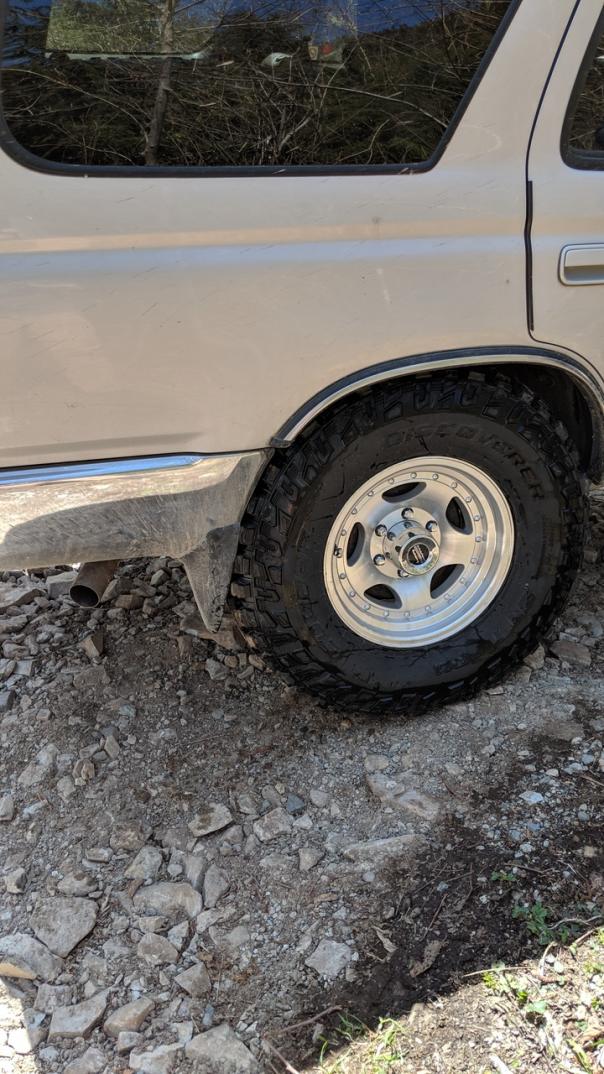

Any advice on how to clear 33's? I have a 2.5in lift, will they rub?
Check out the Pro Comp Xtreme MT2 in 285/75/16. I’ve got 5 days on them of heavy off-roading/crawling and can’t say enough good things about them. Our terrain here has similarities to yours. Coming from the Cooper STT Pro I cant believe how good these work in sand and rocky hard pack desert. They are also “D” rated and under 50lbs per tire. Almost 15lbs less per tire than the STT and really noticeable with our motors. The only negative I have is they’re fairly noisy at highway speed. 4Wheel Parts usually has them at $250 off for a set.
If you are willing to get SPC UCAs, on the "G" setting, several here have stated that 33s can fit with no pounding. This is what I'm doing now...
That's where I'm at and no problems. Using ~4.5" BS wheels with the STT Pro 285/75-16. Actually thinking I may back off the SPCs to "F".
Only rubbing I have is at the back on the stock mud flaps at full flex.
If you go the "F" route, please do share, PM me even, if you don't mind. Curious how that goes...
I have SCS wheels - 17 X 8.5 with 4.3 BS
Kings are settling now, adding a winch in the coming days. Will likely get an alignment later this month (don't need to drive it), allowing more time for the springs to settle...
Will do, may be a while though. I had them crank the LCA bolts so I got as much caster as possible (before tires and wheels), and am now borderline on camber, even with the SPC UCAs. My plan is to start backing off on the SPC caster settings and try and get the camber back to where I want it without having to resort to the BFH on the pinch weld. Might even be able to back it off to the "E" setting, but that may need some loving with the hammer. For now though, it's getting into play season so I'm gunna run what I brung until something breaks (or fires shut down the forest for the summer)
