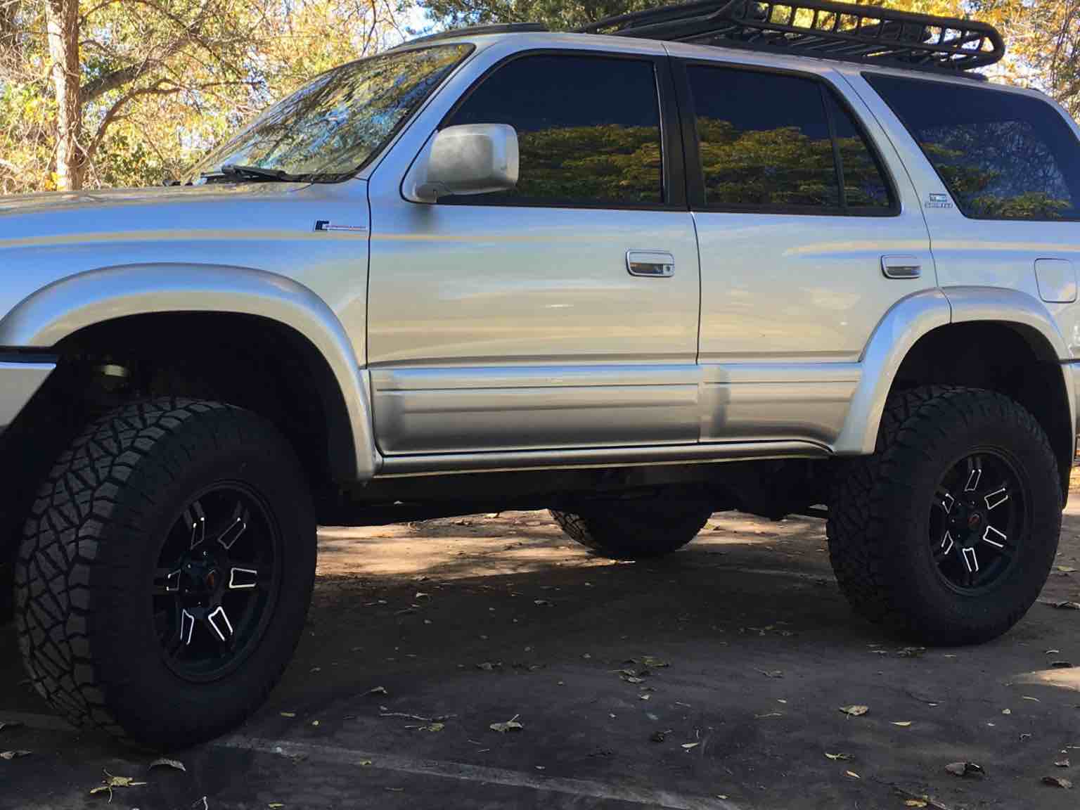

I liked them so much so that I got 17's...more options that way anyway. But yes there is that wheel investment price for sure. You might consider some of the cheaper flat black alloy wheels from 4 Wheel Parts...not bad quality and can get them well under $100 each.
Look, in the long run 16's are a dying breed. I went through this with my Jeep and just went back to 15's but not an option for us with our Runners. They were a "few year" thing and then they moved to 17's and larger...blame the manufacturers. There are less and less options in 16's and those available are more expensive as manufacturers move away from them based on sales volumes of the other sizes...which is why the Ridges aren't even offered in less than 17's. So again I just saw the need to get out of 16's anyway. Allowed me to get the offset I wanted and 17's were a good compromise for wheeling and all around. More clearance around rotors and all too.
Here's my Ridges on 17's in 285's...C's.

Really nice setup on your rig! Love it!
