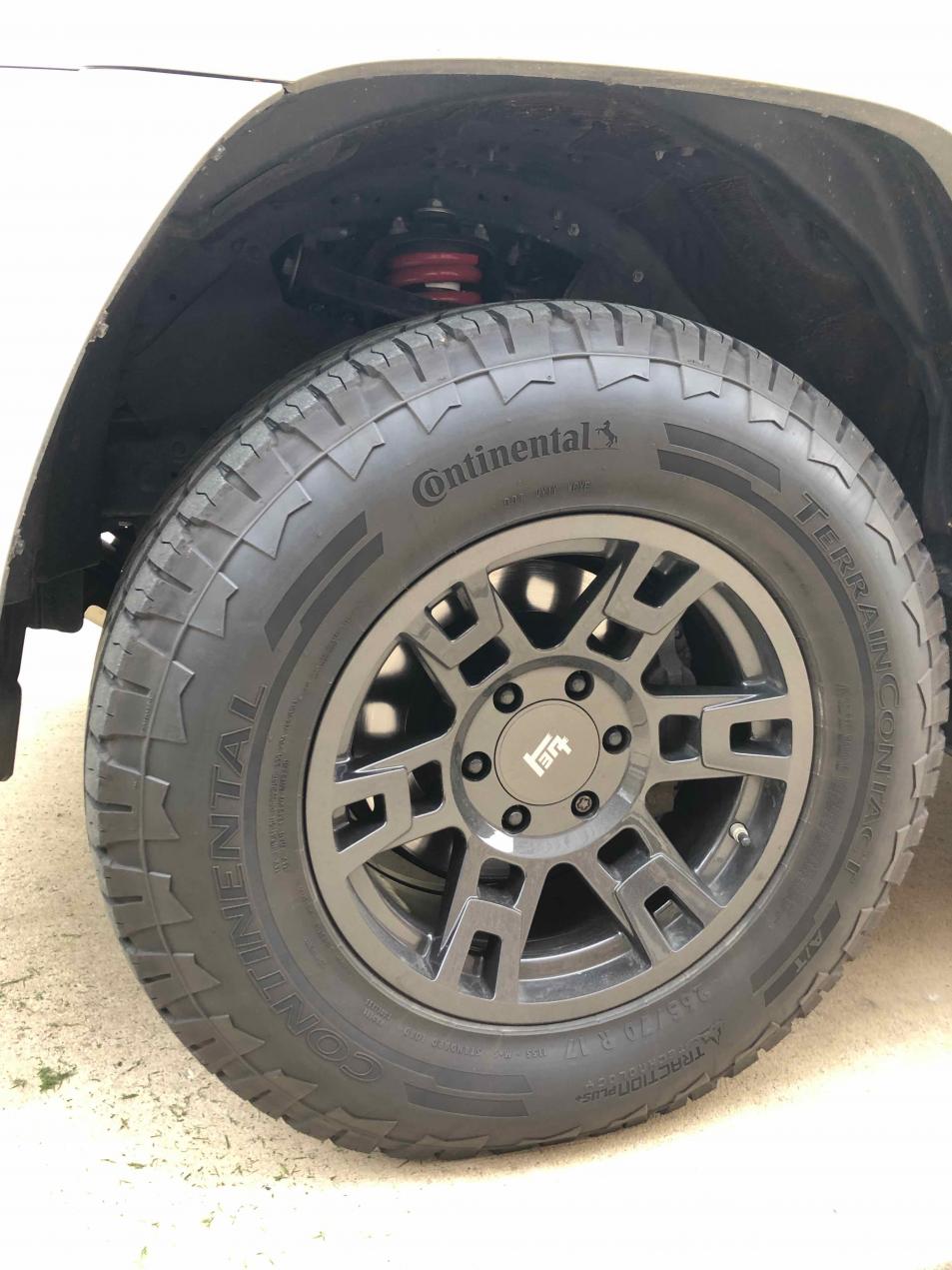

I went with these - Continental TerrainContact A/T OWL 255/75/17. I thoroughly reviewed owner comments on TireRack and watched a video on these particular tires. I bumped up from OEM 265/70/17 to obtain a slightly narrower footprint. Drove on the Ohio Turnpike in a variety of winter conditions with no problems. Very satisfied after approx 6,000 miles on these tires. Spedo error is negligible.
Toyota TRD Black Wheels PTR20-35001-BK

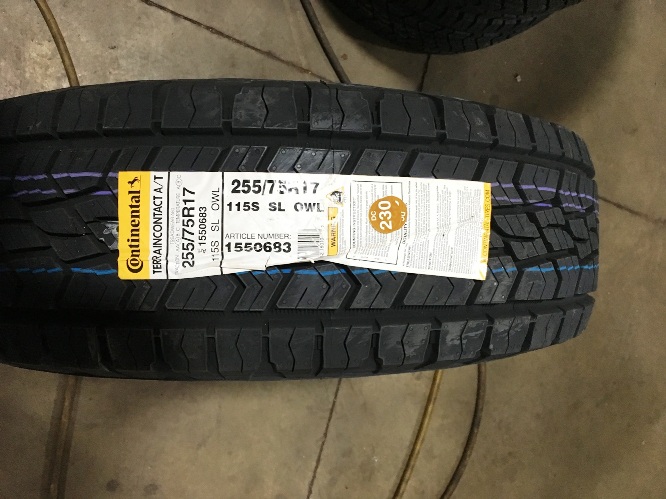

I think these are the same? Do they ride smoother and quieter than the OEM Nittos? Any changes to gas mileage?

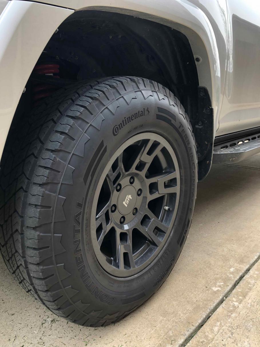

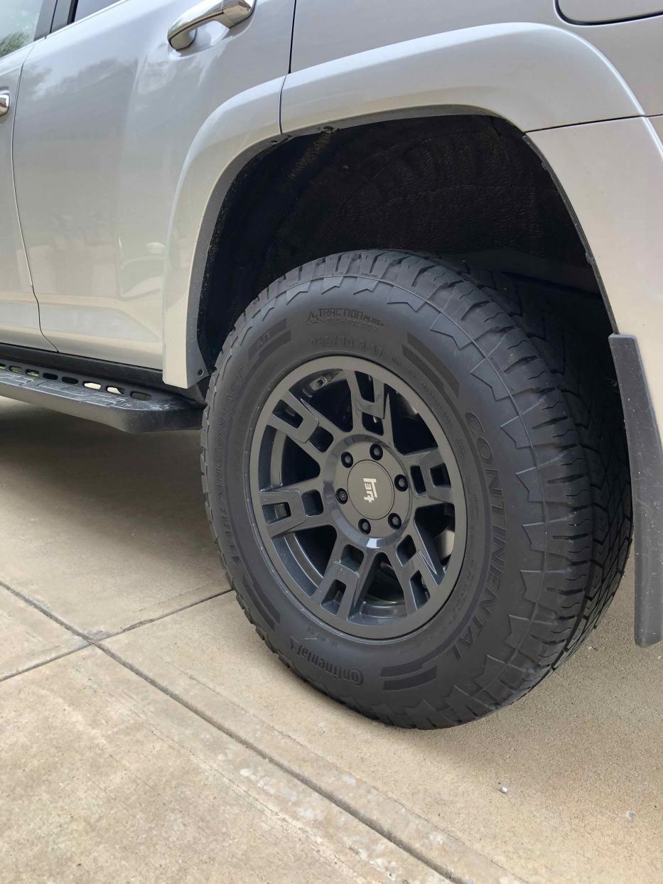

I'm the managing owner of the wife's 14 LE. I put the Trail wheels and Nitto G2 265/70/17 on the truck about 2 years ago. Likely will only get one more year out of them (about 32K total). Her avg MPG is 15. She's a bit heavy on the right foot.
On my 2018 LE, I have the FX Pro wheels and Conti all terrain 265/70/17 with the Magnuson S/C. Right now my computer MPG is showing 17.1 MPG. I think it's a combination of her driving and tires explaining her MPG. We both are mostly city driving.
I don't do a lot of off-roading other then my hunting honey hole that is logging road equivalent.
I really like the Contis. I drive more to the airport than to my hunting hole and they are very smooth and comfortable on the highway at 65+ MPH. I will be getting the same set for her truck likely early next year.
The only suggestion I have is to make sure you get the tires road force balanced. I didn't the first time and had wobble at speed. When I asked/demanded to get the tires on the hunter road force machine I had zero issues. They are smooth. It takes them about an hour to do that...but it's worth it.
The truck is dirty...and so are the wheels. But I still think they look great on the truck.
