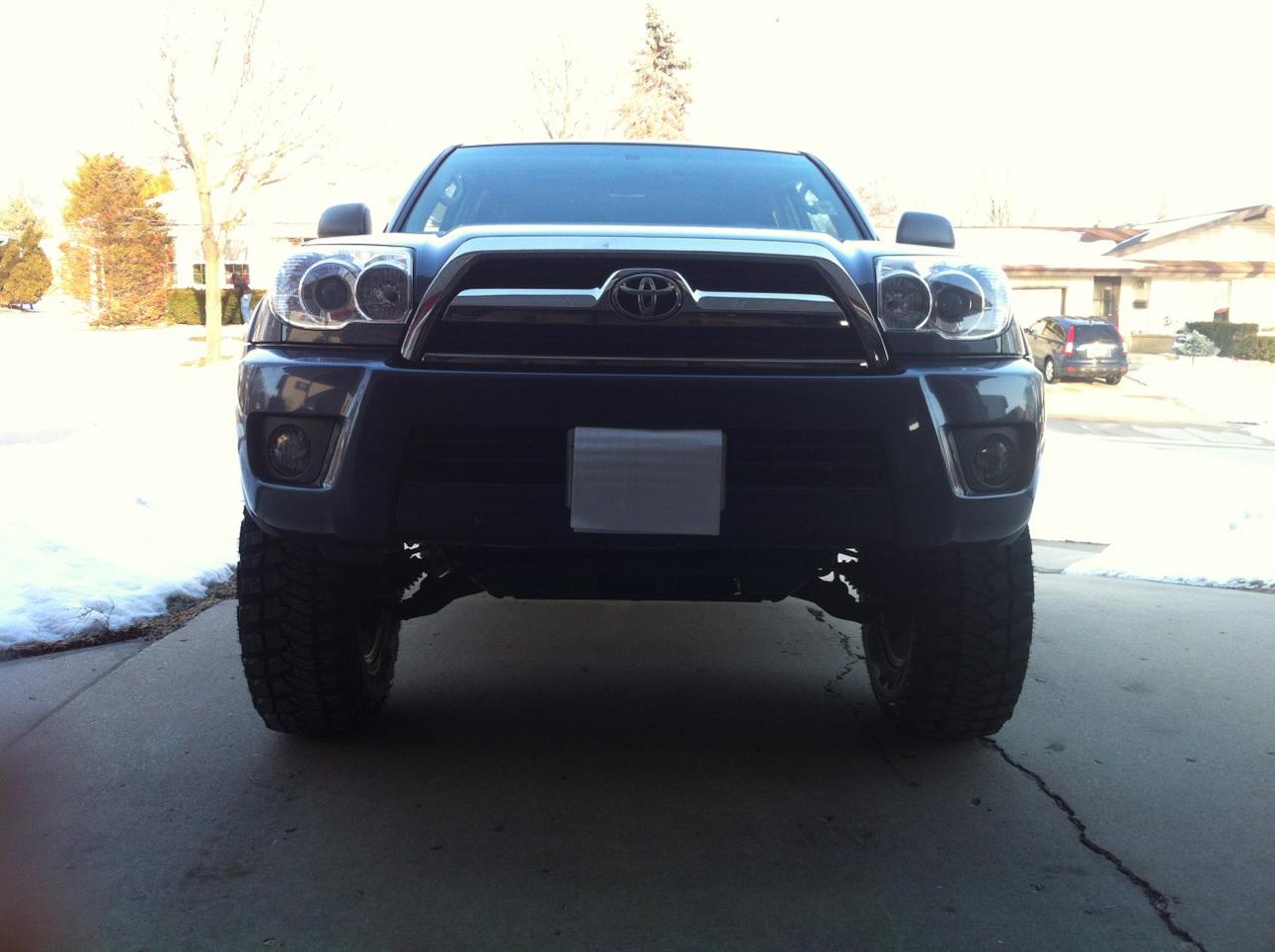

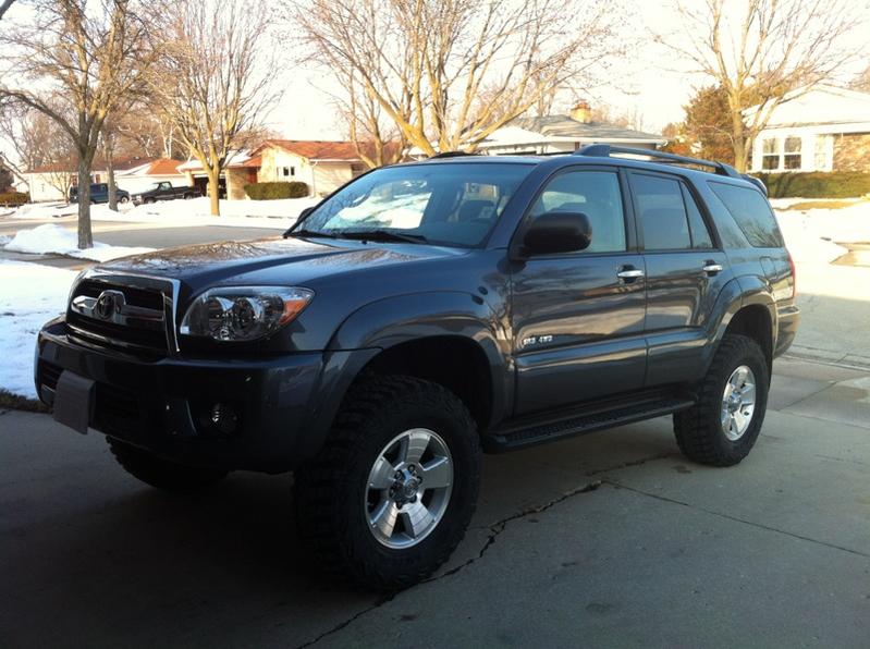

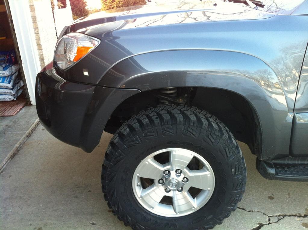

Well, pulled the trigger today. Put the GY MTr Kevlar 285/70/17 on. So far so good, no clearance issues, no rubbing, etc..., but have not taken offroad yet. I have not noticed any power loss issues, but have not had it over 50mph yet. I had the wheels turned fully both ways and looks like there where will be no issues with the bodymount. I am quite pleased at this point. I actually like the way it rides better then the stock tires.
