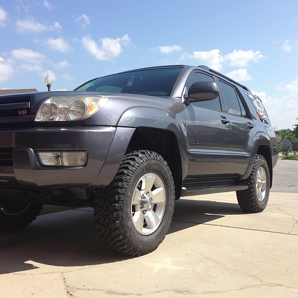

im running the 255s bfg MT w/ blistens and fj shocks on all 4s. great ride. noise is minimum and they look great. no real lost in mpgs just my 2cents
